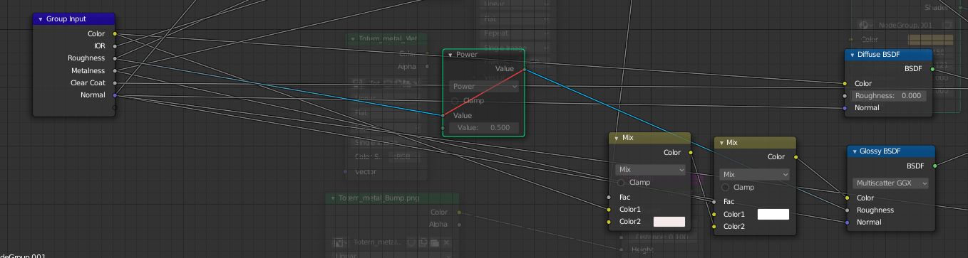

    Glad you’re still interested in learning how it all works! Can you share a screenshot of what exactly is different? The only change I can think of is that they changed how roughness is calculated, so this power node is no longer needed:
