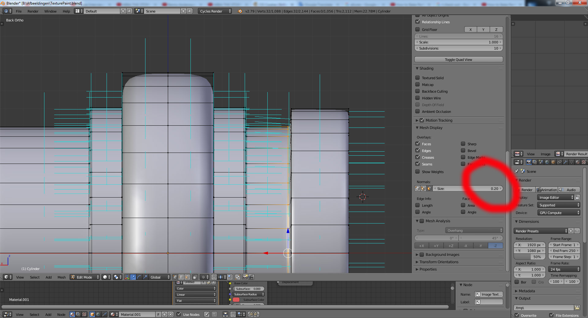

    Check out the Guru his tutorial somewere @ 8:23. Maybe that is the issue.
    A help to find the ray distance are the normals. Activate the normals to see if no normal is hitting an opposite face and use that normal length as the value for the ray distance in the baking tab.
    Your UV looks a lot simpler now.
