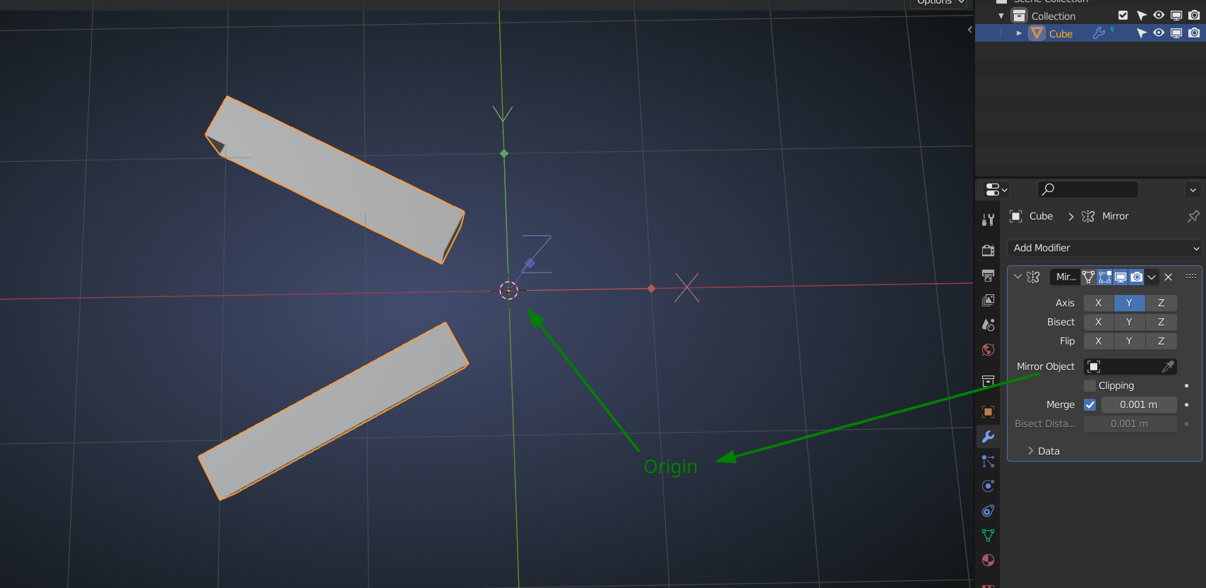

    This is because you Rotated the handle in Edit Mode (or Applied the Rotaion) and it is exactly what you should expect; When not spicified, the Mirroring is done around the Origin of the Object:

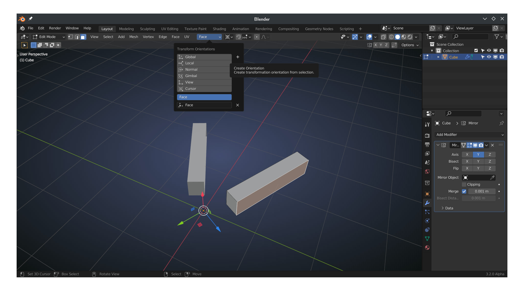

    An exact way of solving this could be:

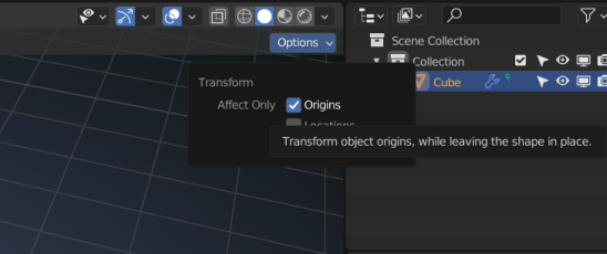

    in Edit Mode, select a Face of the handle and click the + to create a new Orientation:Then in Object Mode go to Options and check Affect Only Origins:

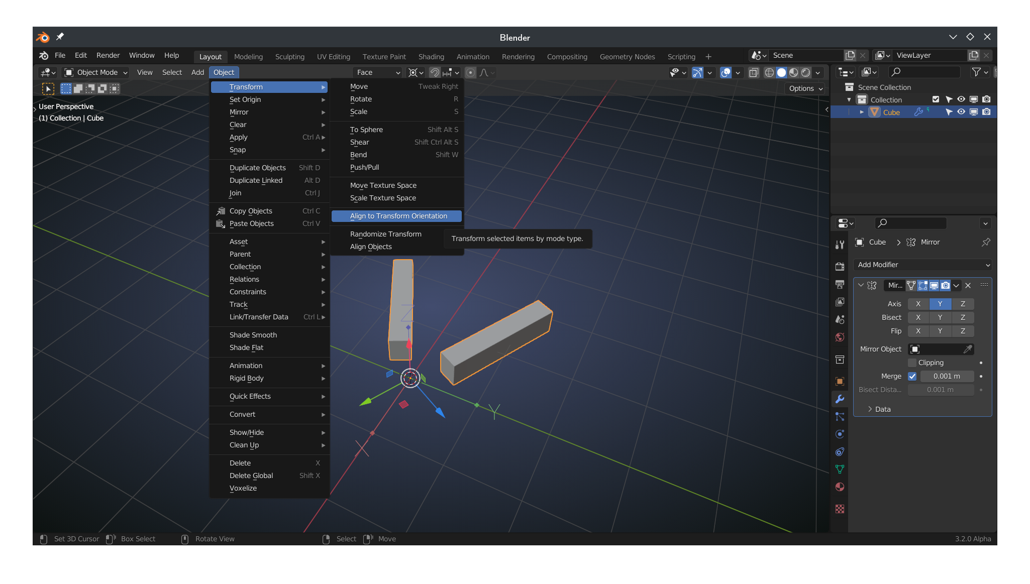

    Then go to Object:

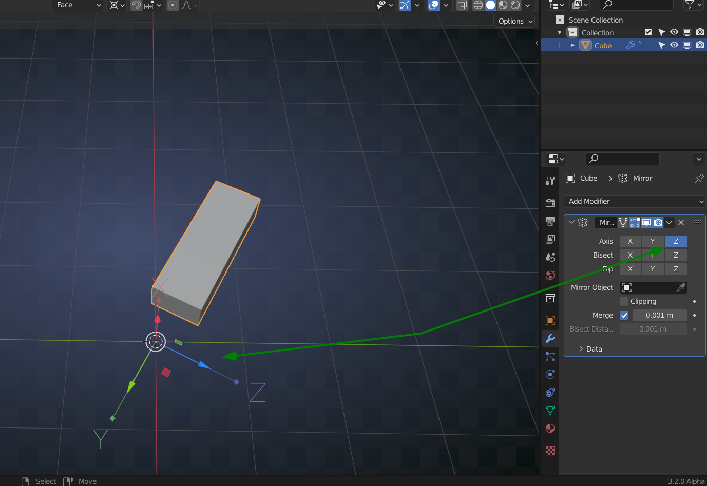

    And then your Object’s Origin ‘fits’ to your Object again. You might need to adjust the mirroring axis:
    Don’t forget to uncheck the Only Origins Option.
