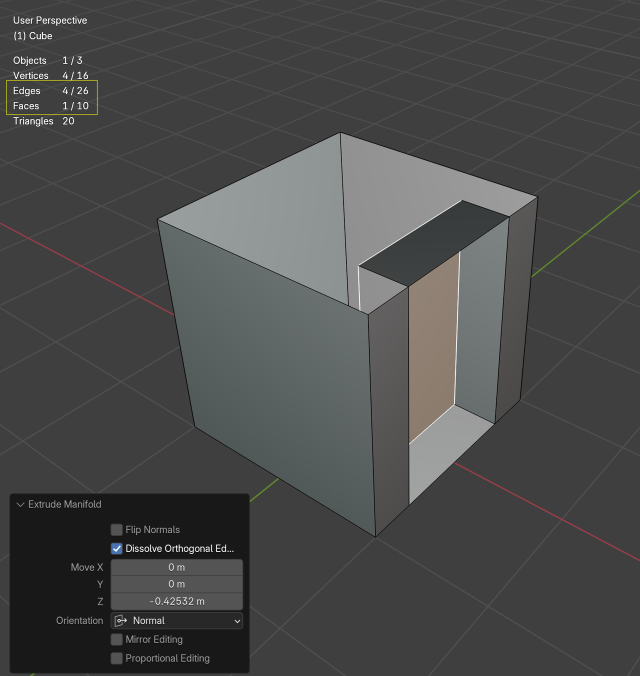

    Hi @toffieplay ,
    That’s cool tip, but if you followed along and Deleted the top and bottom Faces (~0:48), this doesn’t work.
    If, you would instead have Hidden the top and Bottom Faces (with H), the Extrude Manifold does work as you describe:
    Deleted Faces:

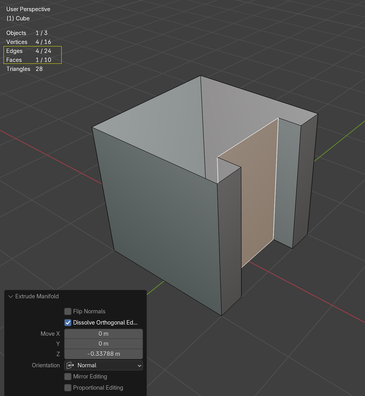

    vs. Hidden Faces:
    ⚠️ It will make a difference, later in the Course, whether you have Deleted, or Hidden the top and bottom Faces, so be careful.
