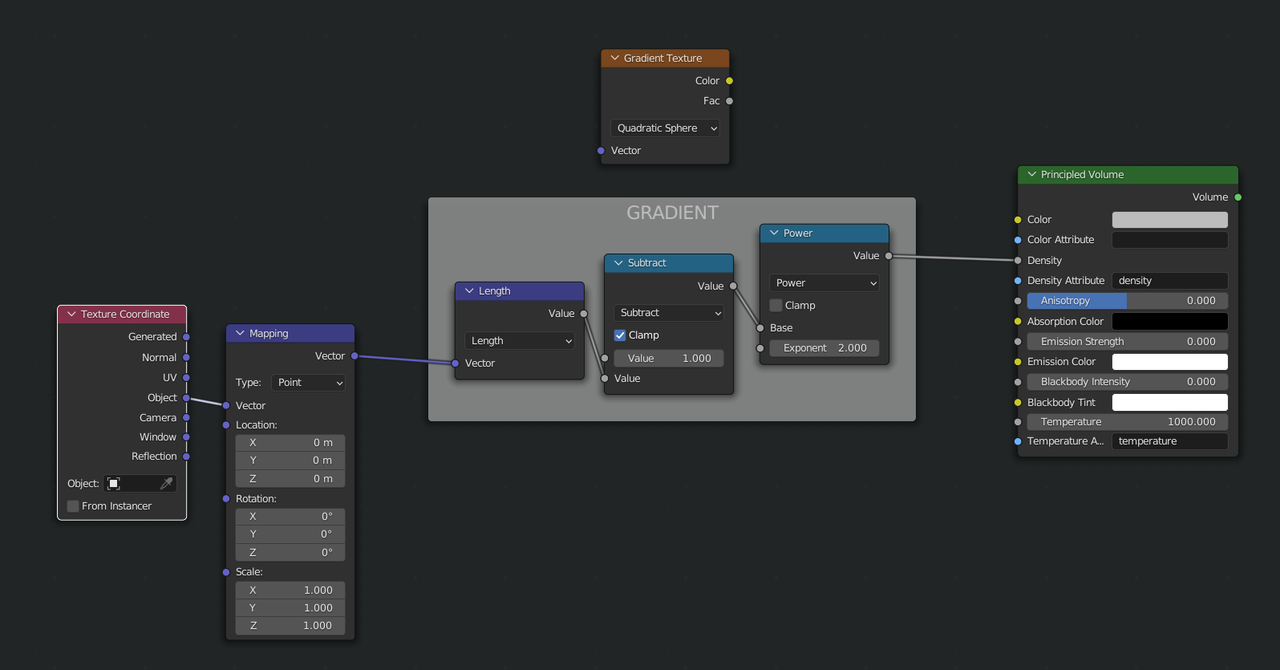

Now, I can’t test this, but if the Texture is the culprit, maybe you can use Math and Vector Math instead, like this:
The Power Node is to match the Quadratic Sphere, without it you’d get the Spherical Gradient.
