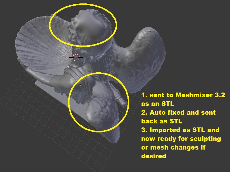

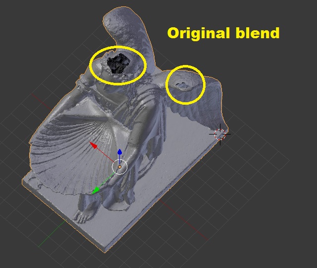

    Found…a way to fix imported sculpt problems….
    Imported from Blender Swap an kneeling angel, Exported it in STLformat, used a free program called Meshmixer 3.2 (http://meshmixer.com/download.html), did an auto fix of the mesh,and saved it back in STL format.
    Imported it into blender and now I am ready to do any sculpting on the repaired area I need to do…
    See before and after pic below
