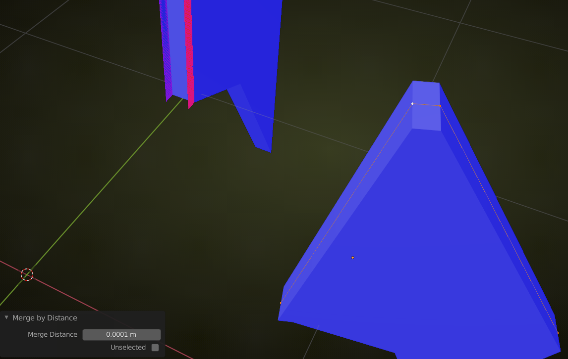

    Hi stawpeed, thanks for the .blend file.

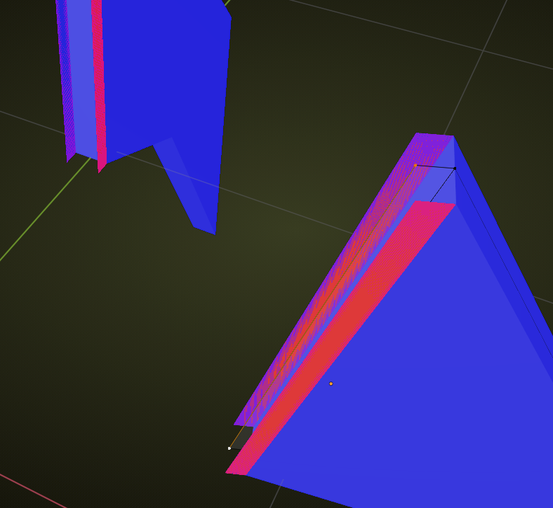

    You have double vertices in you fins:
    Remove doubles solves that:
    Easiest solution is to select all the five fins in Object Mode, then go into Edit Mode, select everything with A and then press M > Merge by Distance when using 2.83+ or press ALT+M > Merge by Distance if you are using 2.82 or before.
    Then you can join them.
