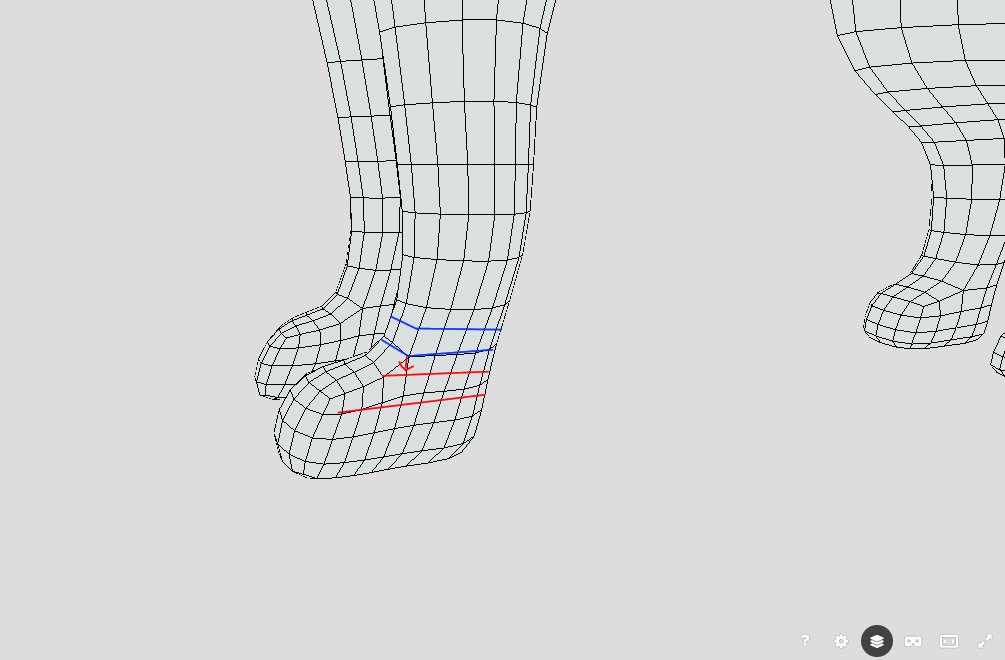

Adrian Bellworthy
    I agree!
    Not easy and you have done really well.
    The only thing I noticed, is the 5 edge poles by the ankle joint. Not a major issue, but potentially if you was to rig and animate your husky.
    I would probably move a couple of loops down a little (Red)
    Then add a couple more (Blue) for the ankle deformation.
    I might also help with the shape of the paw.
