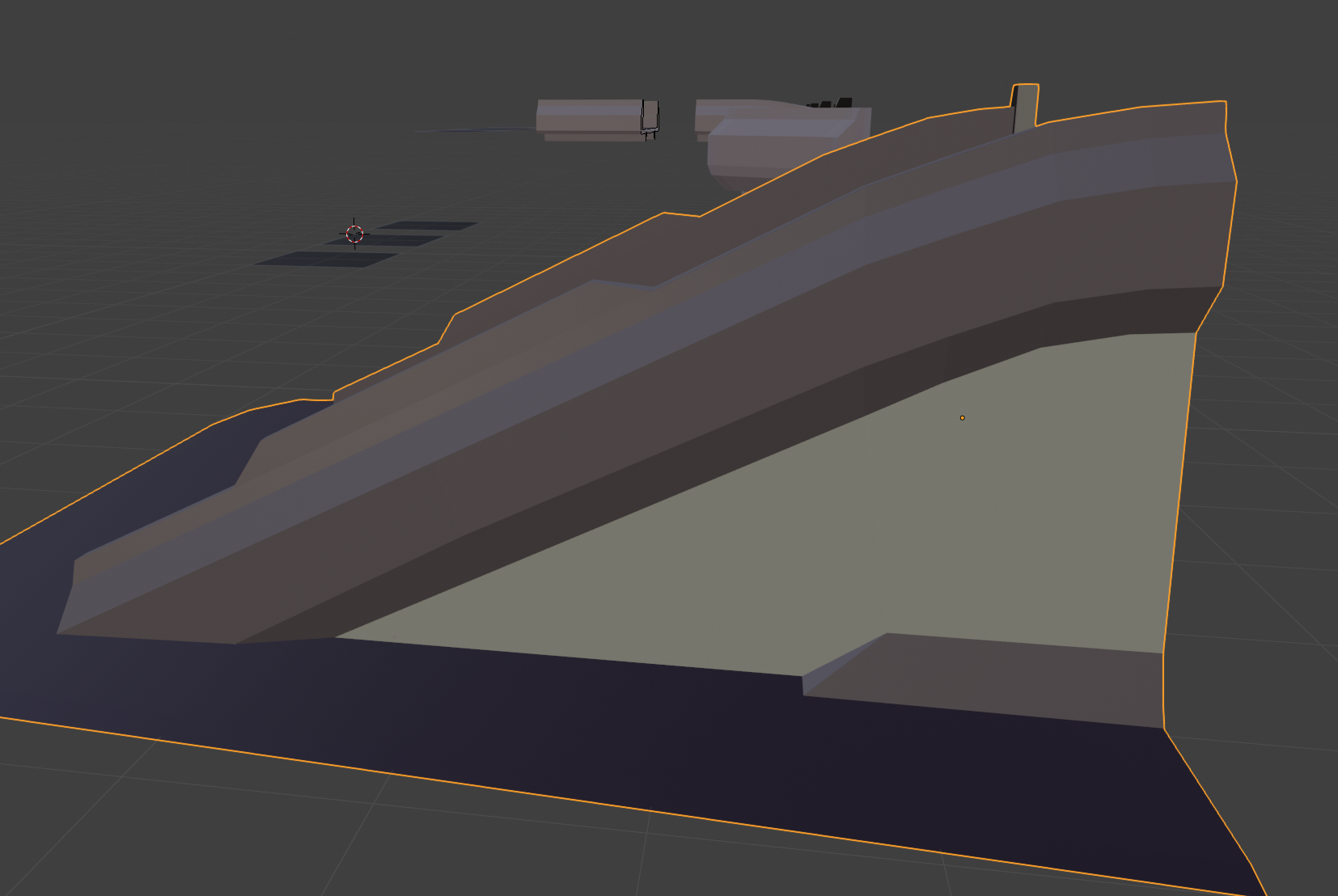

    Shawn, thanks for the tips.  Yes, in face selection mode, I found the fill had issues with completely filling faces when there were adjacent edges at odd angles.  I ended up marking seams for these faces and performed the UV unwrap again.
    This was the ramp mesh–I probably went to extremes to solve, but the results were what I was hoping for–I’ll employ your suggestions moving forward.
