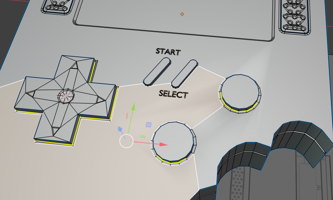

    Hi Riccardo @ricky_leaks ,
    I am confused; how do you know that Face isn’t flat?
    My guess is, that it actually is flat, but are getting some ‘Smooth Shading’ issues.
    Try lowering (in the Z-Axis), the Edgeloops around all the buttons (I only highlighted a few here, but basically the ones from the first Inset):
    That’ll change the Smoothing Angle and should improve the Shading…
