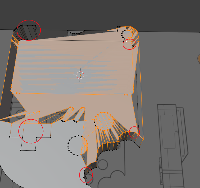

    Looking at the image, I don’t think you have selected the same vertices as in the lesson. You may want to take another look.
    You could have some double vertices causing some of the issues.
    When selecting the vertices, take note also of what edges are selected.
    Don’t panic, the best option here I think is to start over. I can see many other issues in you mesh that will cause problems later.
