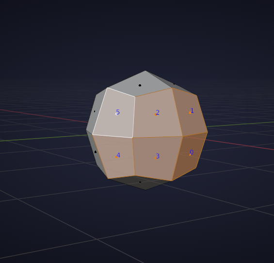

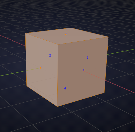

    The problem is, that all the Faces of a Mesh are numbered:

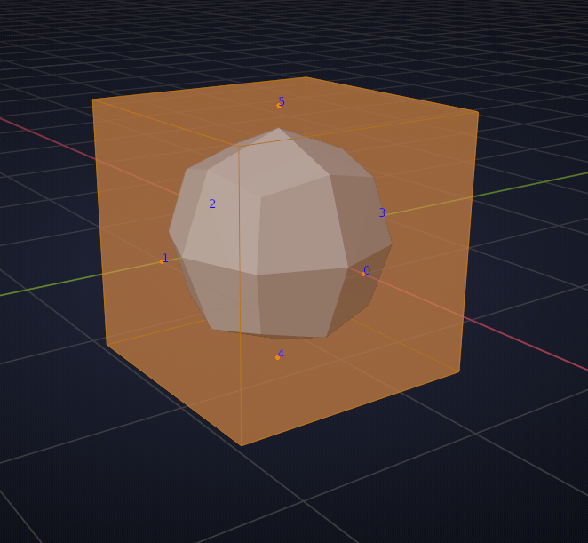

    When using a Subdivision Surface Modifier:
    When you now Apply the Subdivision Surface Modifier, all the Faces get re-numbered:
    So, if you have carefully placed one hair at each side of the Cube, they are now clumped together at ‘one’ side.
