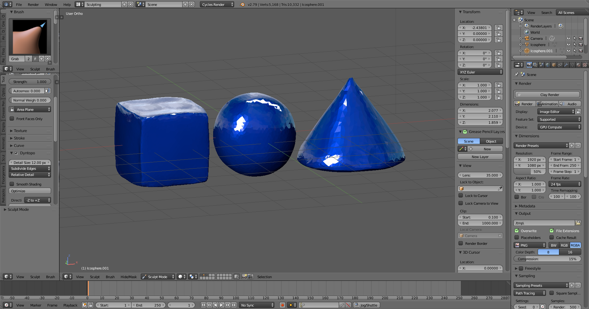

    BC1-1801 Week 3 Homework Submission (Part 1)
    My results from the shape exercise.
    One of my biggest problems with the Sculpting layout is that the visual reference of the brush you are using doesn’t stay persistent.  To get around this, I’ve set up this window layout where the left panel is open just wide enough to capture the T panel.  I have that left panel divided into 2 so that the top part will always show the brush and I can use the lower one to browse between the options.  This way, I can always see which brush I’m using.  I try to use the hotkeys, but if I can’t remember one, I still have easy access to find the one I want and can still see my settings so that I can change detail size, curve options, symmetry settings, and so on.  (I wish that the developers would make that box that displays the brush persistent so you can always see it, but until they do, this is a work around!)
