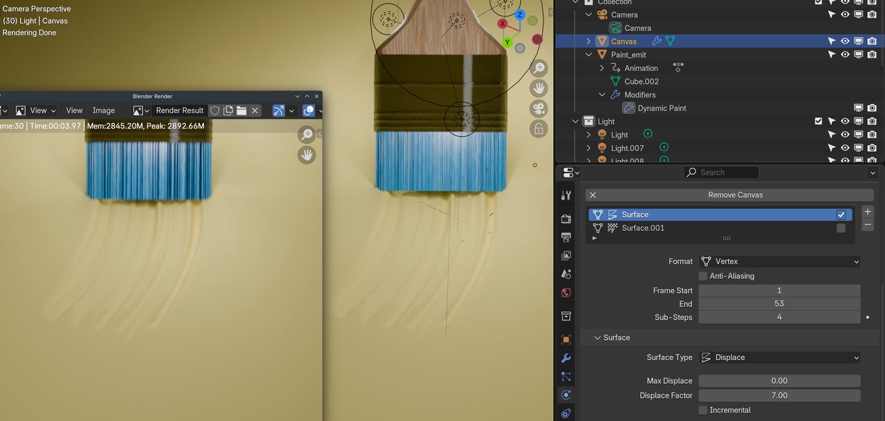

    Hi Andrii @broov3rD ,
    First of all, thanks for the file!
    I haven’t been able to find what’s wrong yet; I can Render just the Displacement:
    but as soon as I also enable Surface.001 (the paint), it only Renders the paint as you show in your images.
    If no-one else knows why this is, I will look at it again tomorrow, with a (hopefully) fresh brain; I am intrigued 🤔
