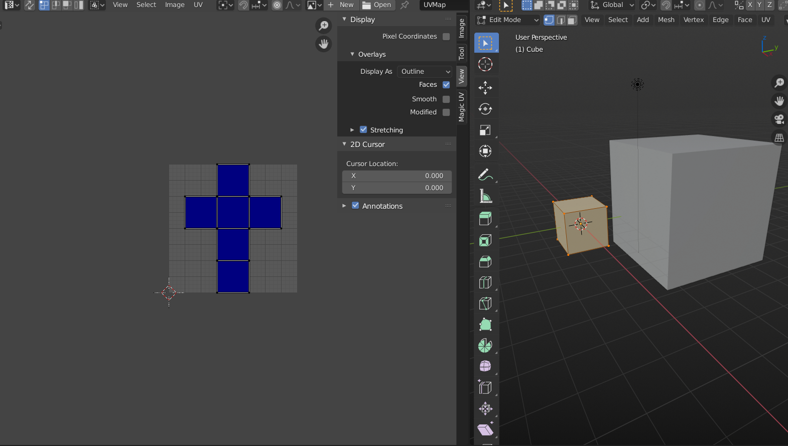

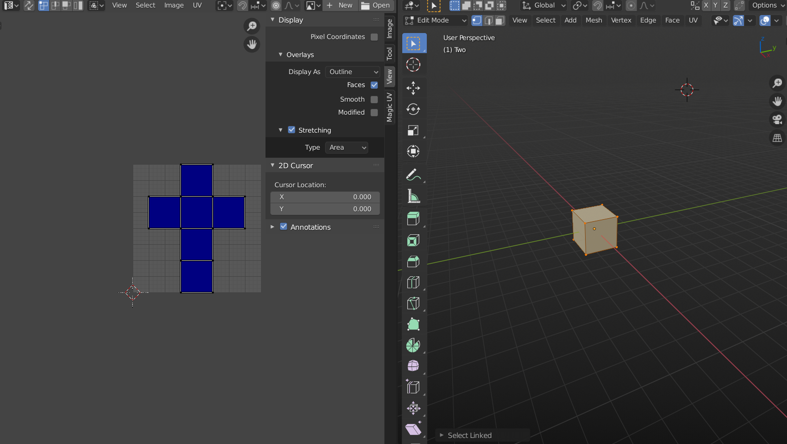

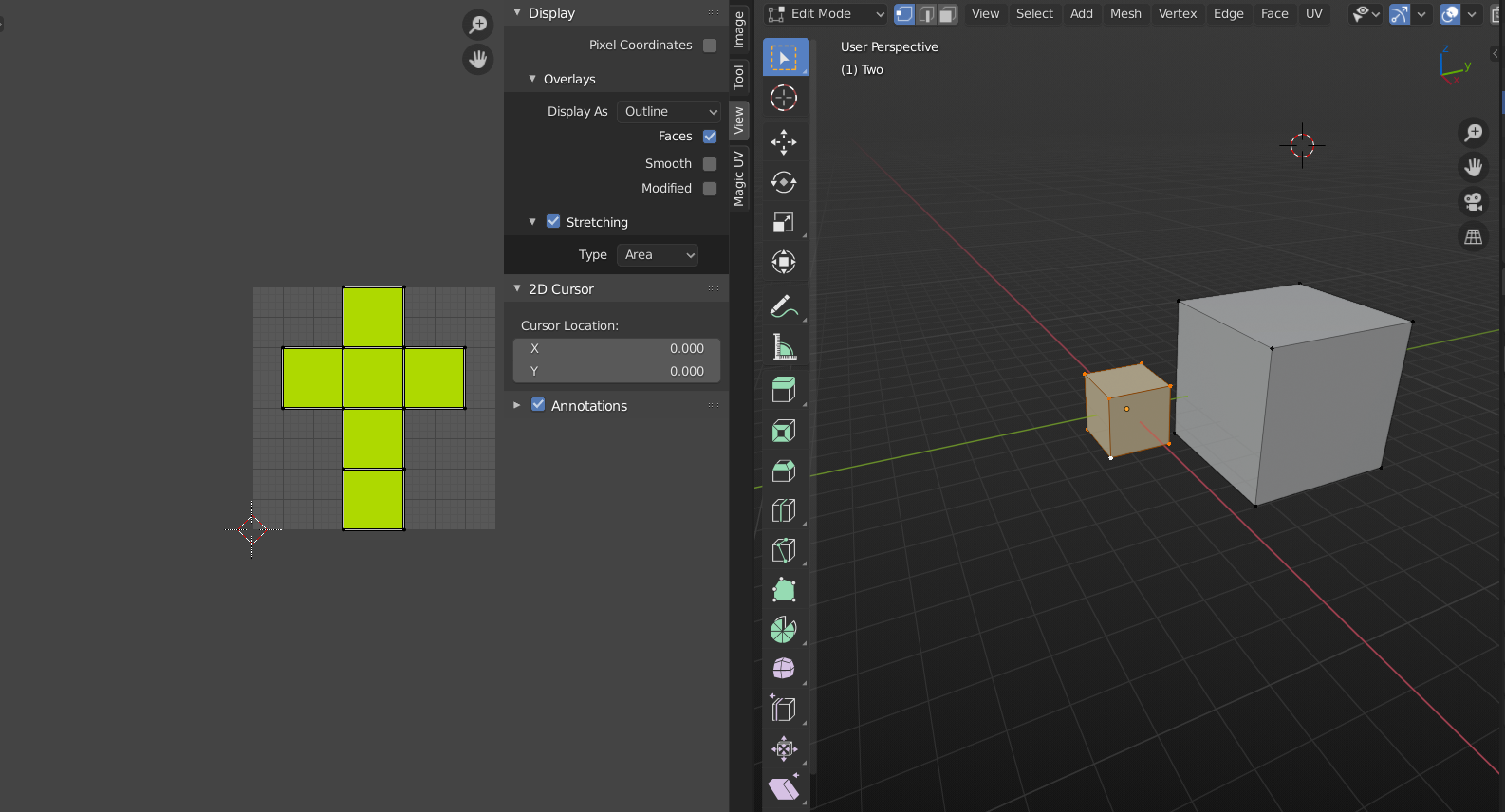

@johndangcg Have a look at these pictures.
Although only one cube is selected, Blender calculates the Area stretching using both cubes (because they form one Object).
If they would be separate Objects:
