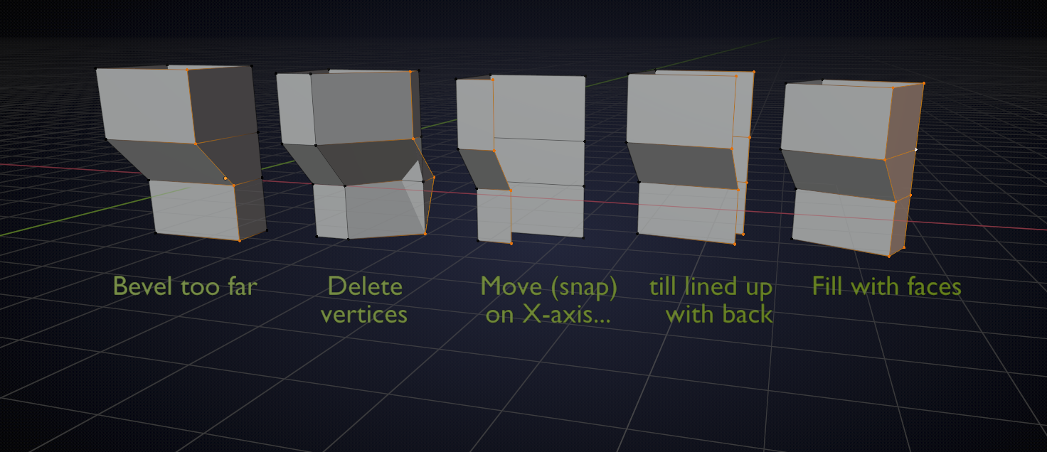

    If you Bevelled too much, you can (in this specific case) ‘repair’ it like this:
    Hope this is clear enough;)

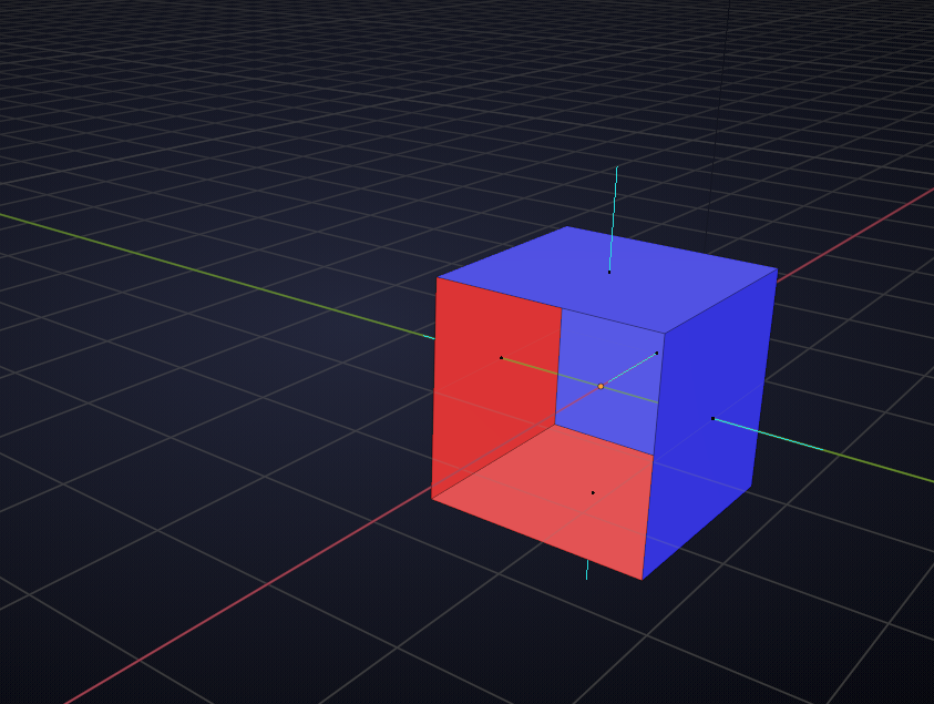

    Now to the Normals:
    basically, every Face has a front and a back side and by definition we say that the normal of a Face is a vector, perpendicular to the surface, pointing in the front (of the Face) direction. Something like this:
    where the blue sides are the front and the red sides are the back of the Faces.
