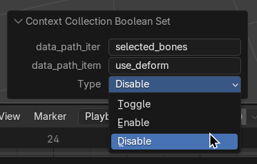

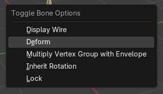

    Yep I’m right click select.
    And yes.  You can use the Shift W (Specials Menu) or just plain right click if you have the default keymap.
    However, this only works in Edit mode.
    But it’s something I do do quite often.
    Then I always bring up the redo with F9 to force it to be disabled rather than toggle.
