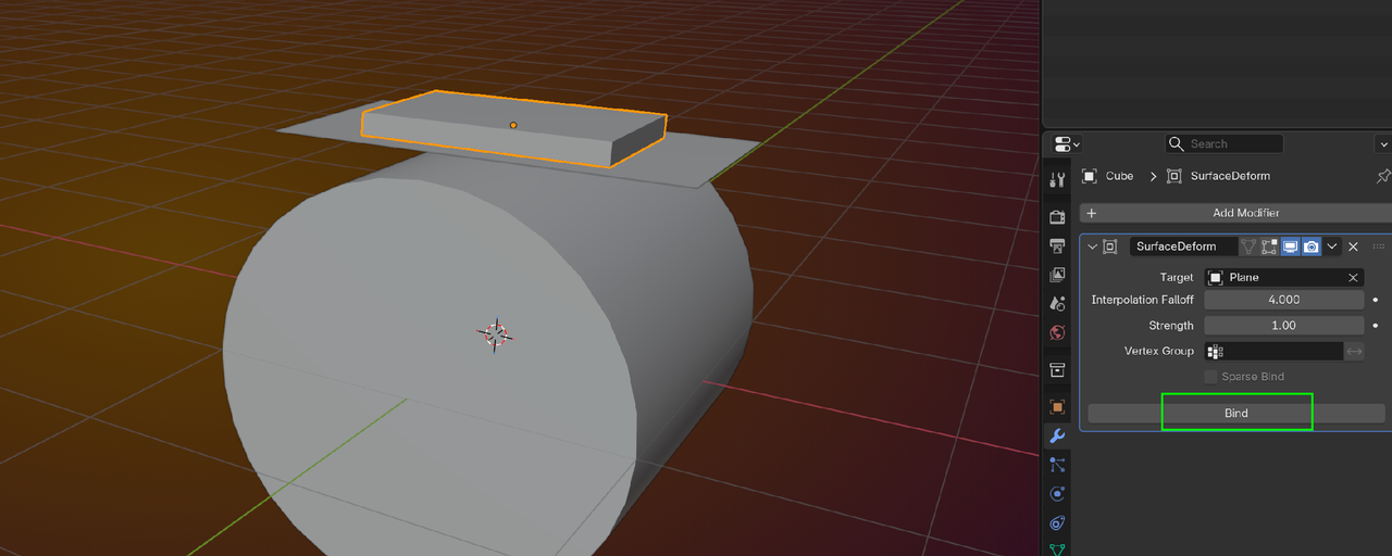

    And when you like Shrinkwrap, you can also use a Surface Deform Modifier and a Plane:

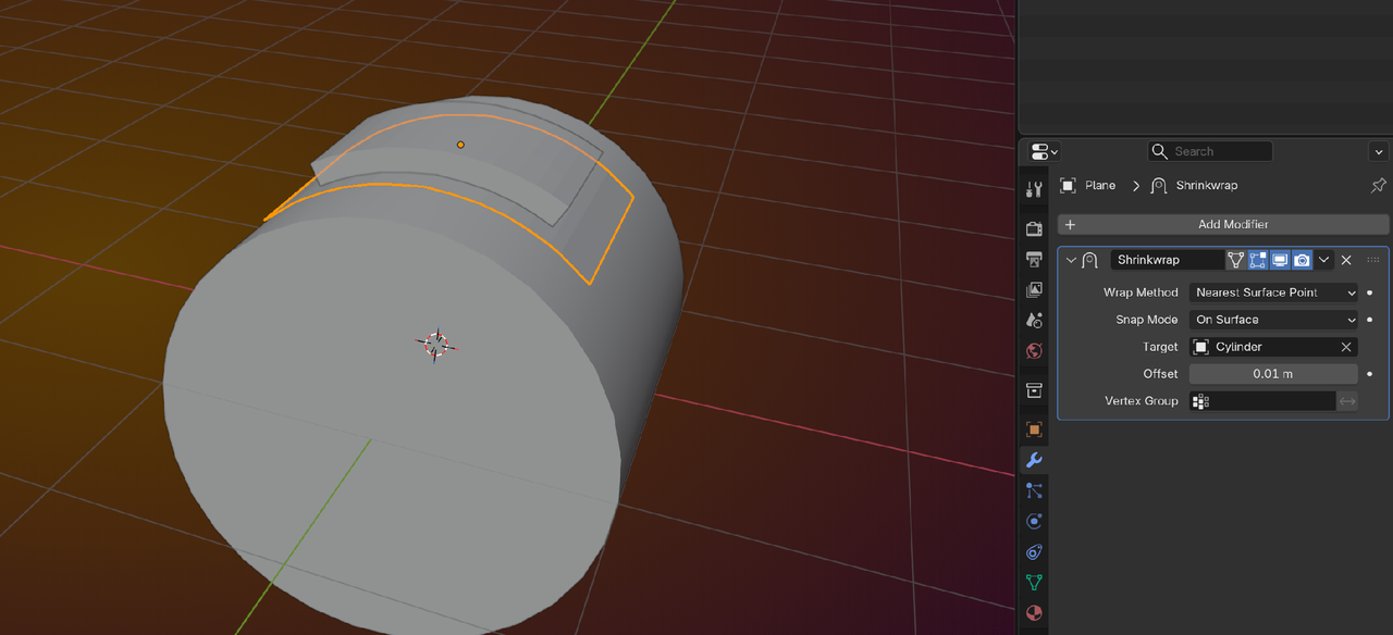

    Bind the Mesh to the Plane and after that, you can Shrinkwrap the Plane to the Cylinder:
    Wouldn’t be my first choice, but it’s good to know the possibility exists (the Surface Deform Modifier is not very well-known and might be a bit under-used).
