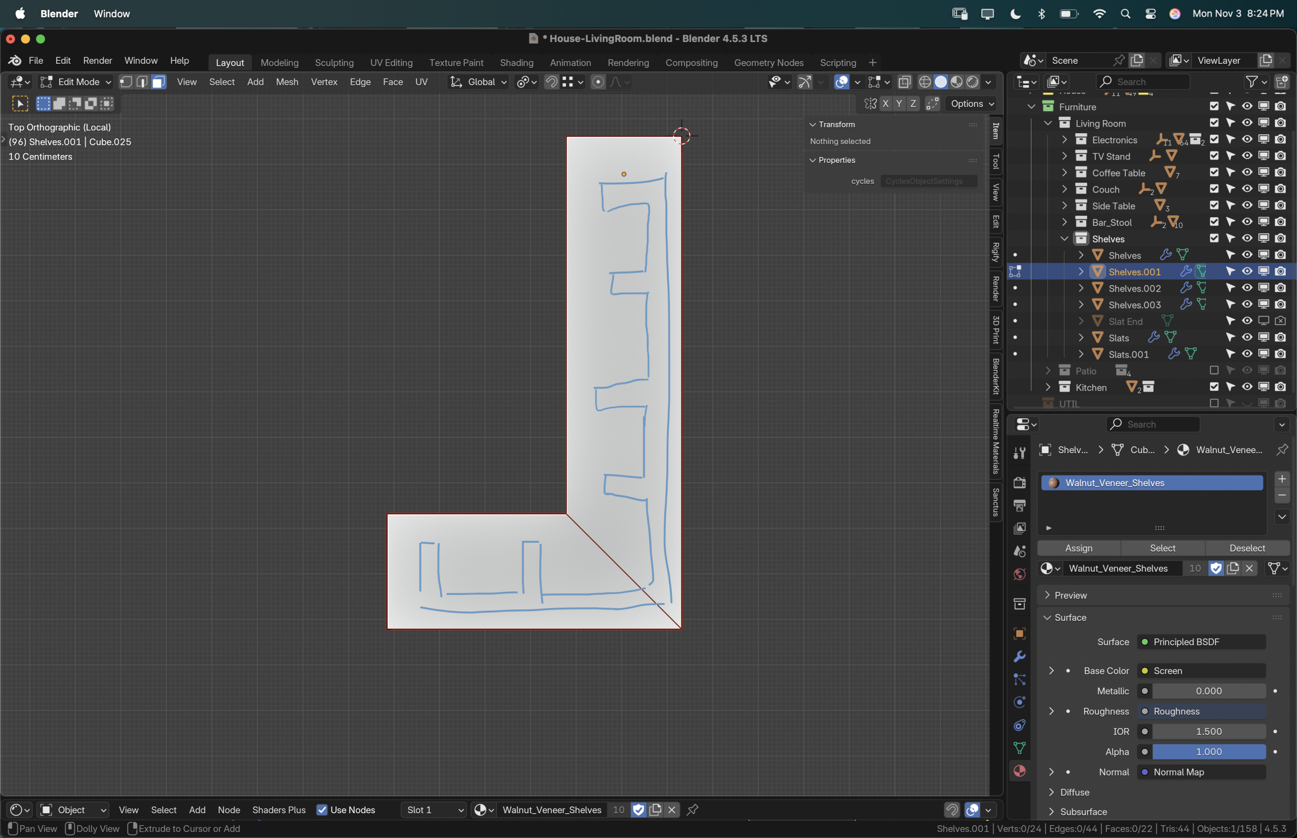

    Nice! Thanks Sascha! Not having the long rods definitely makes it feasible to mount something already mitered!
    Would something that small be able to support a solid shelf plus items on top of it? I don’t have anything that is a MUST be on it, but it’s kind of a more permanent mount and would be nice to have options. Planters can get heavy with water, and we never know… if we could get say 35 to 50 pounds on it I doubt I’d need more.
    Or maybe building the shelf as a plywood box instead of a thick 8/4…
    If I were to extend the support you suggested more like this it would still allow for the miter to work, right? Instead of the tight clearance of rod brackets.
    We don’t have measurements yet. Other than using real world dimensions for lumber (we’re thinking at least 1.5in thick finished though, this project is literally going to help us figure out what do to in that corner). So I’ll iterate a few ideas.
