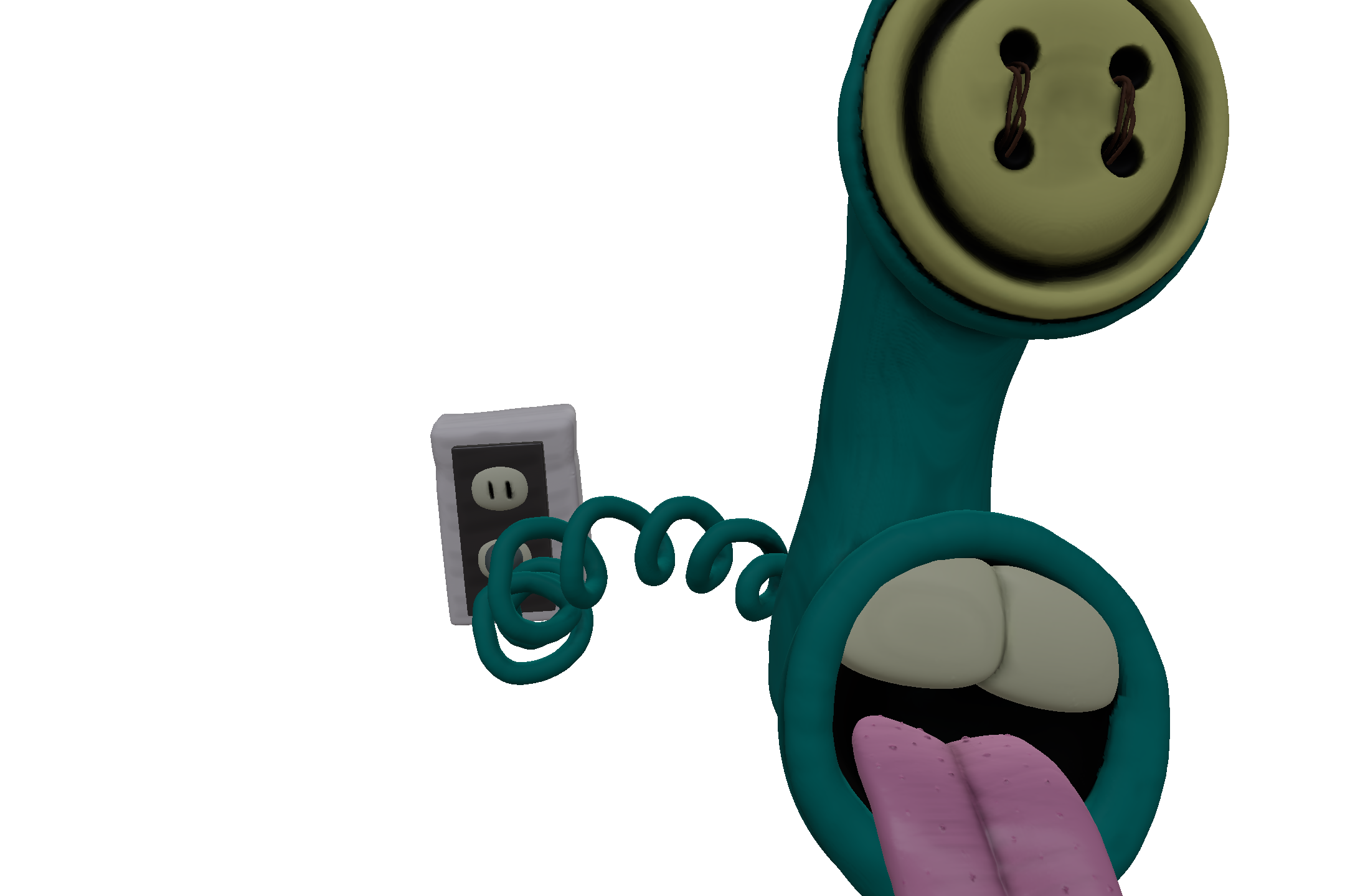

here is an example of a texture exported from Medium:
 this is the “body” texture from my “Mouthphone” asset (pictured below)
It could be a futile effort entirely, but I’m really hoping to find some way (albeit convoluted) to be able to use my original materials/textures on my finalized characters without having to compromise quality.
