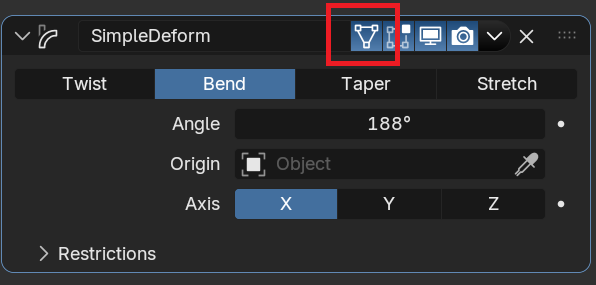

    Hi Vanessa
    Don’t worry, it’s all working correctly. What you’re seeing there is, similar to say a subdivision modifier, that the modifier isn’t actually deforming the geometry, it’s just simulating it. If you were to apply the modifier in object mode now, the geo would follow the shape.
    If you want to see the geo following the deformation without applying the modifier, you can toggle on the “on cage” option in the modifier, which is currently grey.
    You could also toggle off the modifier in edit mode (next button over) and you’ll see that the shape will not appear deformed until you go back to object mode.
    It’s just various ways to work with modifiers and display them however needed in any given situation. 🙂
