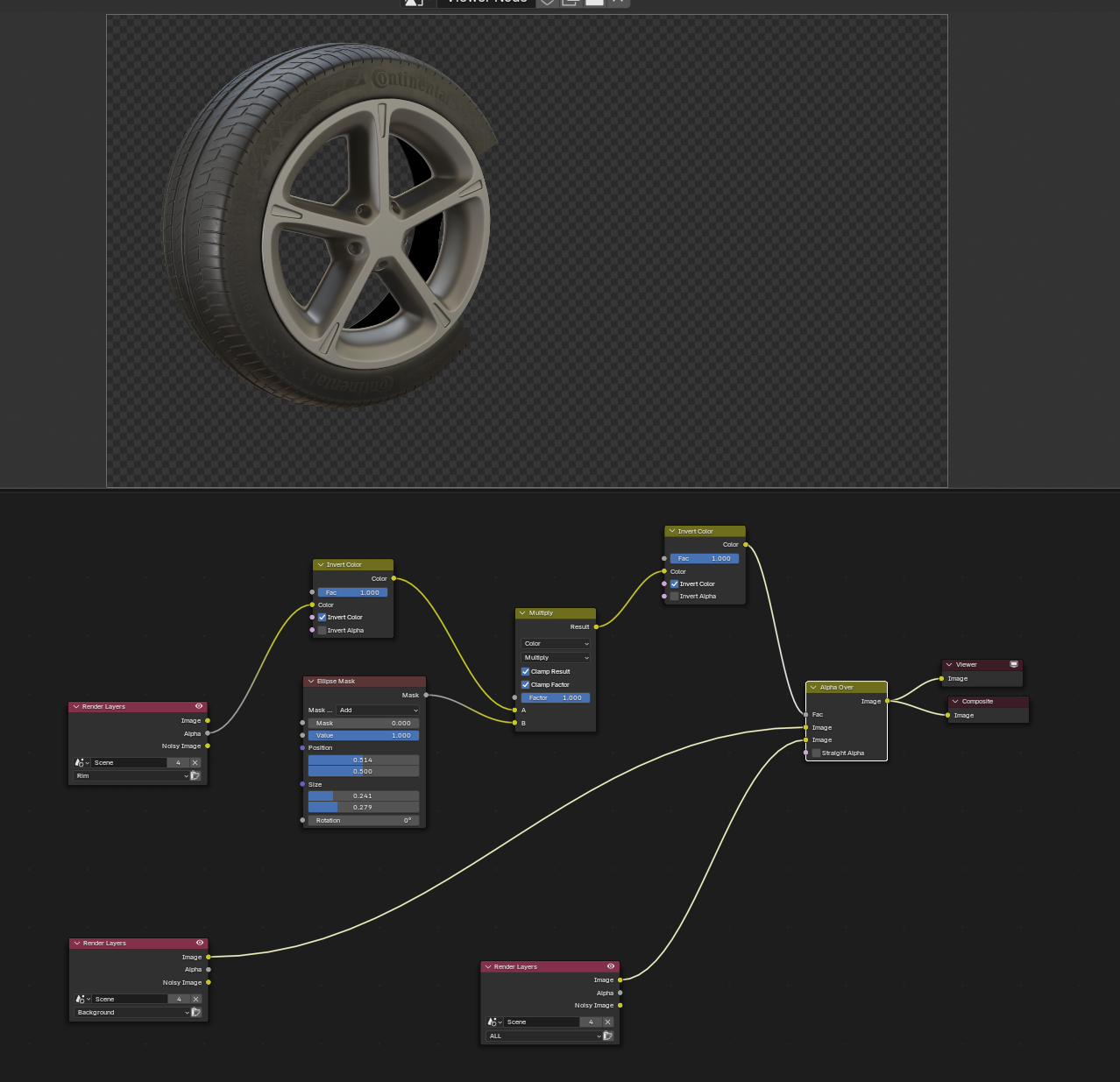

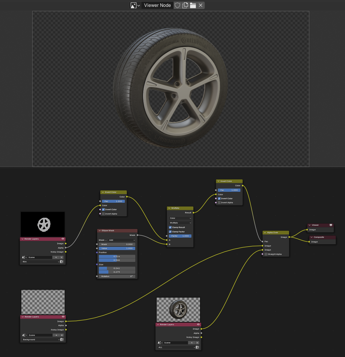

OK slowly inching forward using the ellipse mask.

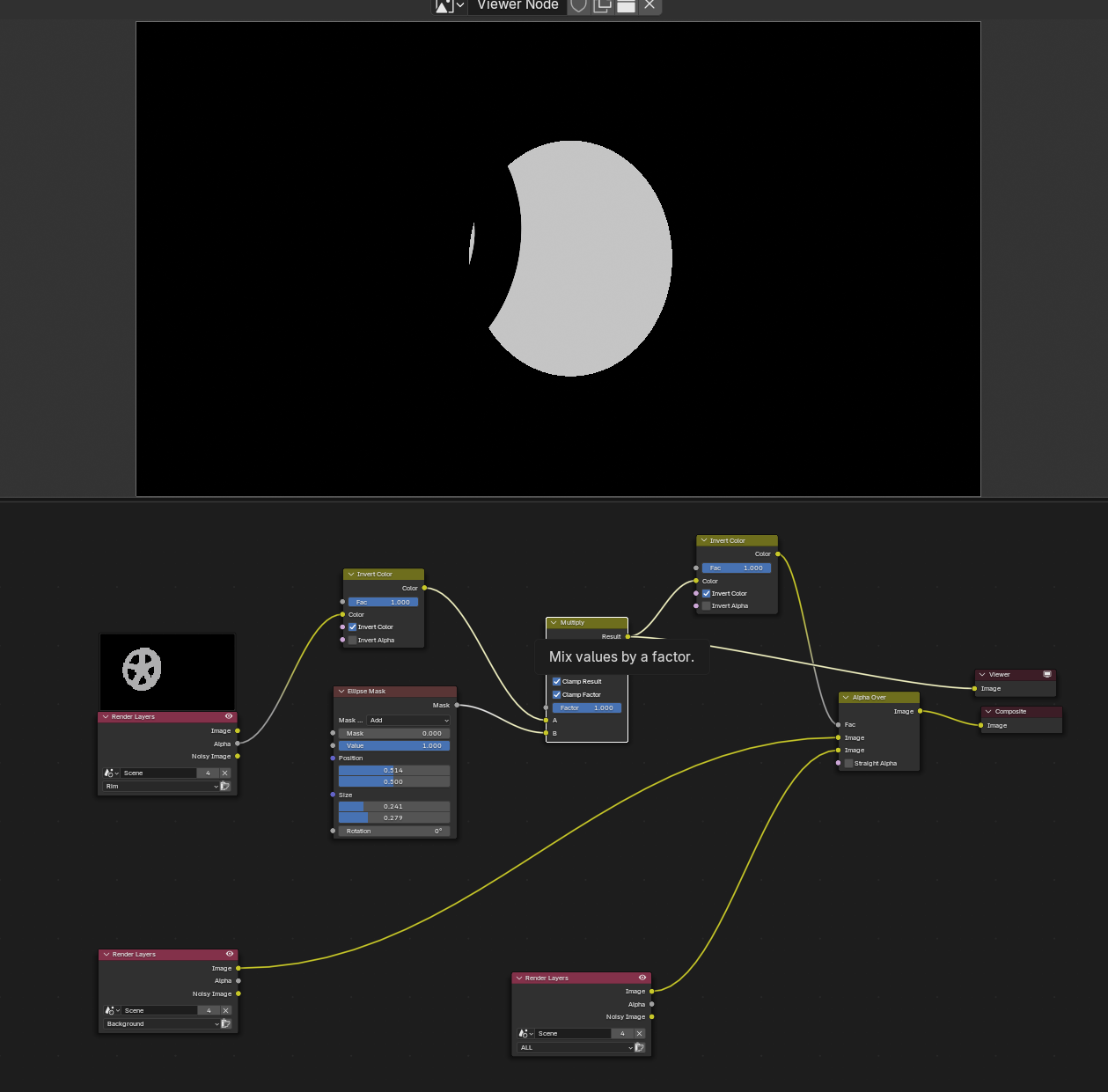

However the issue with this is that if I move the position of the object the ellipse mask position stays in the original position so this doesn’t work dynamically.
I expected to be able to set this up so I can render in multiple positions and the mask is dynamically updated based on the position so I don’t have to keep adjusting the ellipse mask. So… I suspect this does mean a cryptomatte or the dreaded maths nodes.
If we could stick to discussion the alpha approach for the moment so I know the limitations of what’s actually possible. I did suspect a cryptomatte might be the answer and went looking for the explanation in Core Compositing last night but couldn’t find it quickly and it had again become a very late night. I can’t really remember anything about Cryptomattes now.
