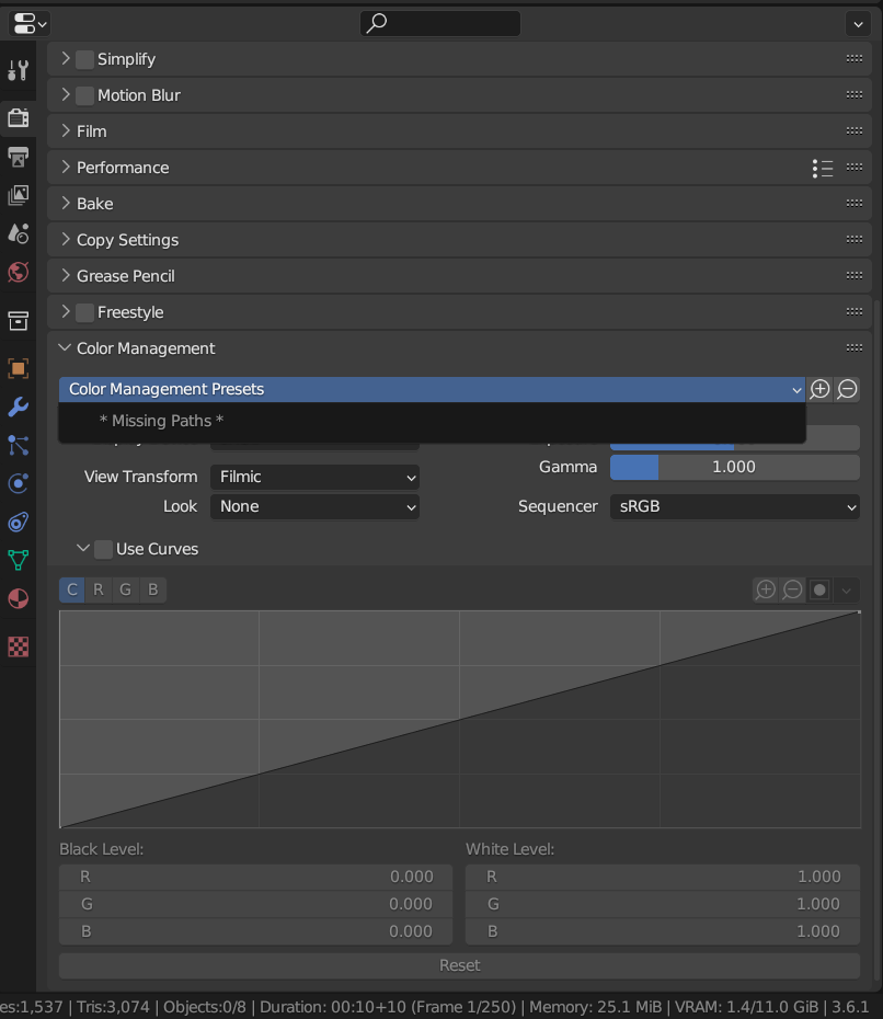

    Just leaving a note here in case anyone sees what I am when diving in on the color management issue discussed above.
    You go to change the Color Management Preset – and you get “* Missing Paths*” with no presets listed.
    Apparently there is a bug related to portable installs.
    I am running with default English language Windows 10 from a “F:\” drive and the paths to color management can’t be found.
    This seems to be documented here and is reported as resolved – For me it is not though?:
    https://projects.blender.org/blender/blender/issues/82081
    Seems I will be forced to use a 3.6.1 installer to address the issue.
    EDIT: It appears to be fixed in 4.0 alpha 🙂
