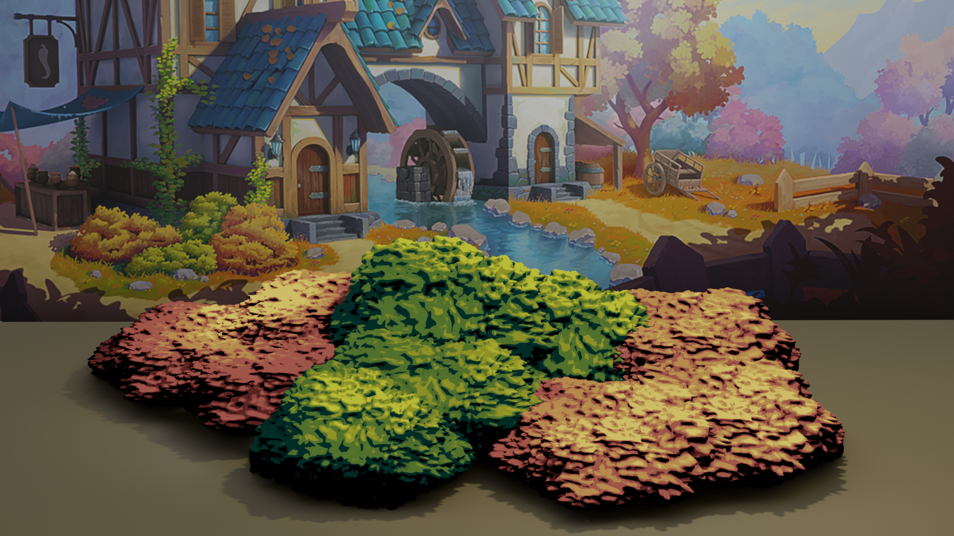

    Here’s my first try at the bushes. I used meta balls to get my shape.  Converted them to mesh.  Fixed polygon issues then added a displace modifier and used a multi leaf texture I made. I also used a smooth modifier to soften the effect.

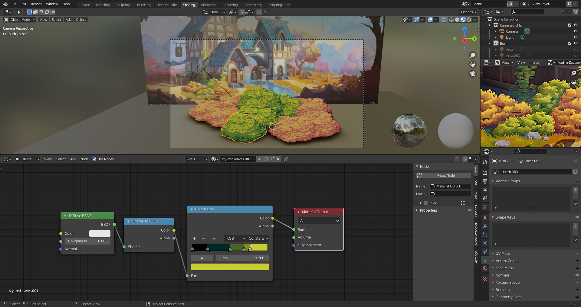

    Here is the Materials I used
