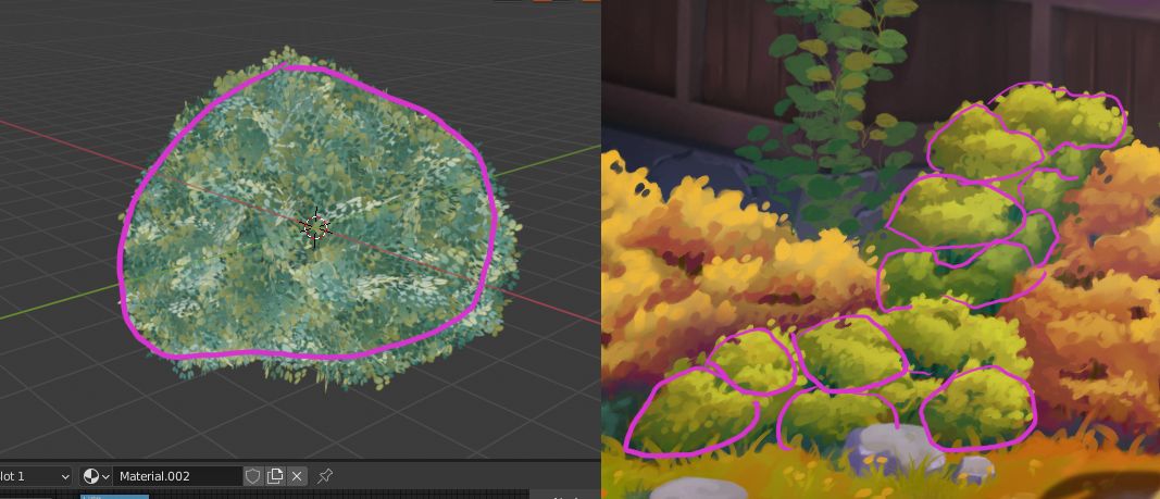

    You’re the last homework submission left for Week 1! Sorry it’s so late – But your bush tests look very promising. Lots of good examples. Excellent work this first week.
    You’ve achieved a “leafy-nes” that I’m happy to see. Structurally I feel like the bushes in the art are more clumpy that yours:
    Yours is like one giant clump. Figuring out how to isolate the clumps while still maintaining a unified bush object would be ideal.
    Perhaps some transferring of normals from a simpler bush mesh could be the answer. Have you seen the Ghibli tree tutorial? He goes over the concept there.

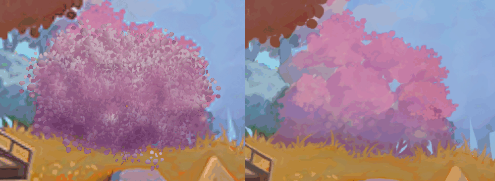

    This example looks extremely promising too:
    Only criticism is that it feels very flat. I’d like to see more definitive light to shadowed regions. Potentially could also be solved with normal transfer.
