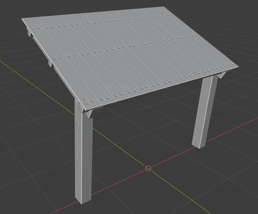

    Excellent work from @svetimas and @fancypigeon! Both of you earned full points from me for week 1 👍

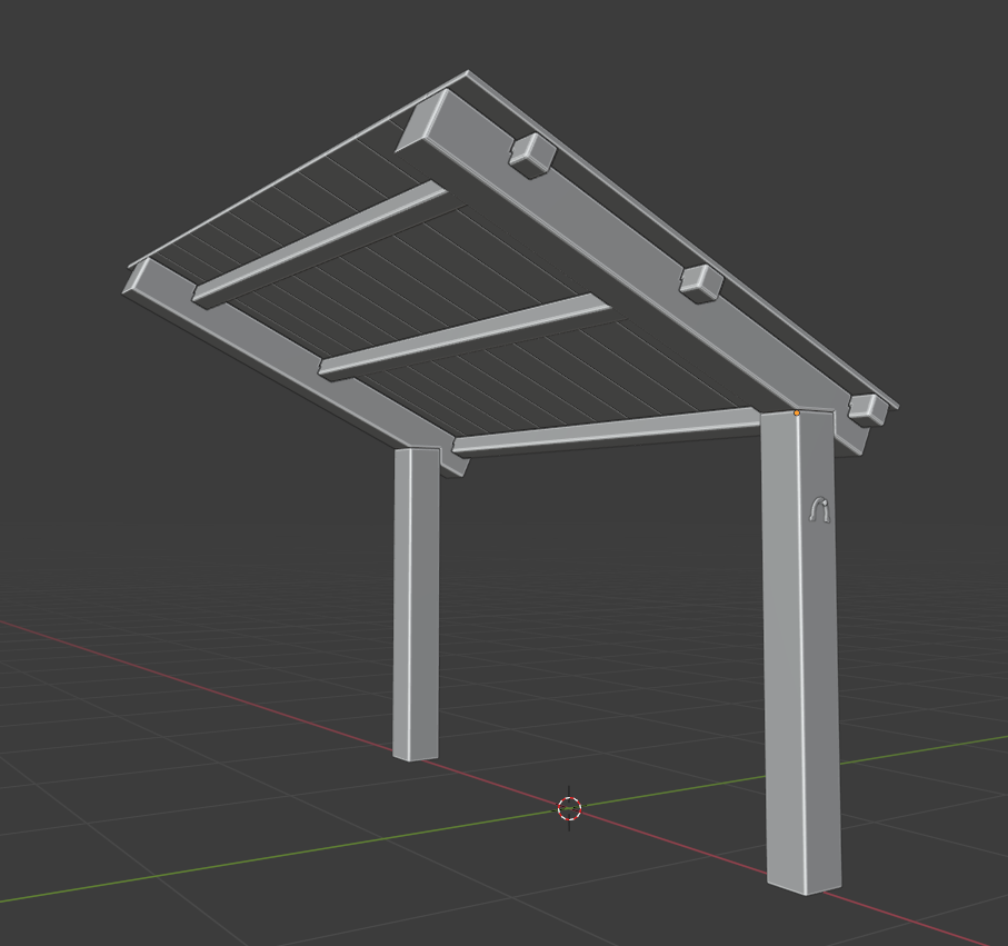

    @svetimas You built your canopy like an engineer. Meaning it’s built the same way it would in the real world, including proper joints and nails. Technically this means there will be some surfaces that are never seen (arguably a slight waste of resources) but I don’t think it’s significant enough to change. So I say keep it the way you have it. Nice work!
    My only note is to double check the size of the horseshoe. It strikes me as kind a small…but I’m also not sure. Fun detail addition though!

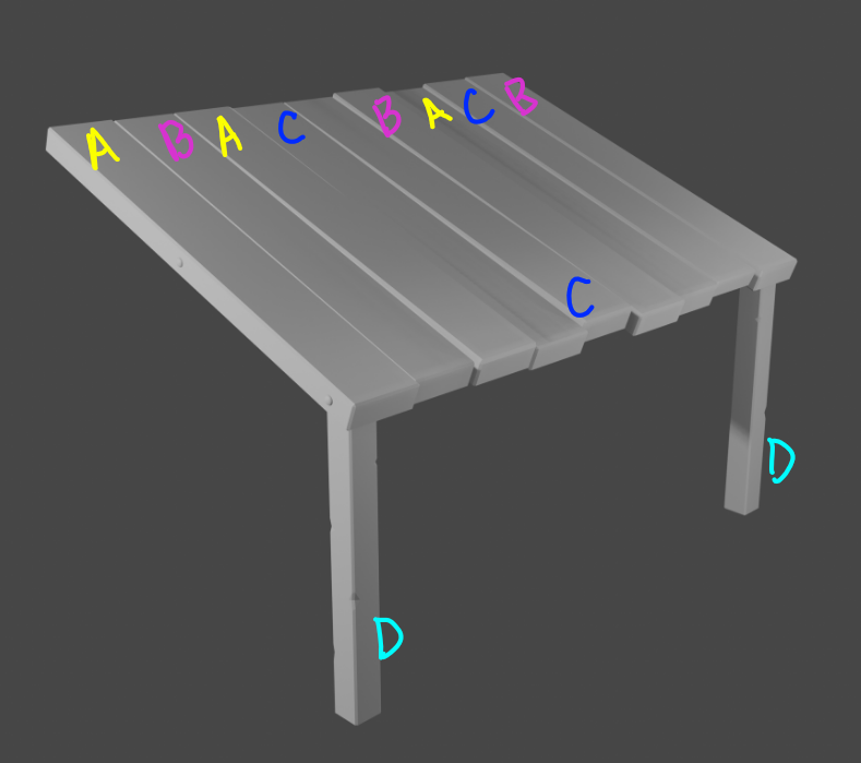

    Advice for week 2
    I recommend both of you consider how you can intelligently duplicate a minimal number of pieces to achieve a complete canopy:
    Each letter represents the same piece duplicated and moved in a random sequence. But they can also be rotated in addition to being moved for added variety. To build it this way means you only have to model + sculpt + texture 4 pieces instead of 11 (in this example).
    It’s the same principle I taught in the Treasure Chest course.
