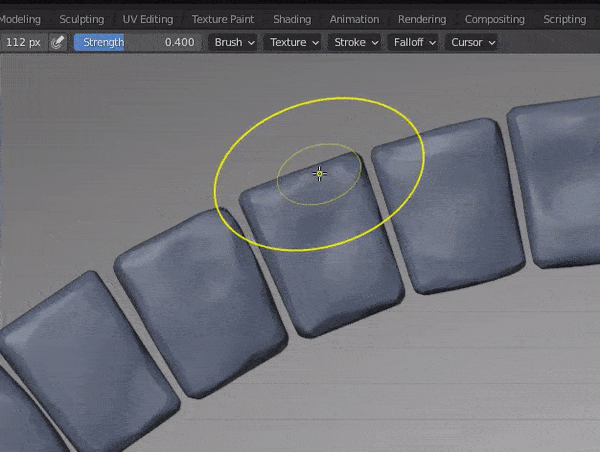

    2.  It looks like you’ll need to retopologize a LO-poly for baking. To expedite this process and avoid retopoing each rock 😵‍💫 I recommend you remove the gap between each rock. It’s pretty simple to do in sculpt mode if you enable auto masking by topology:
      I think this still serves the art and it means you can retopo a whole row of rocks together as one mesh rather than individual rocks.
