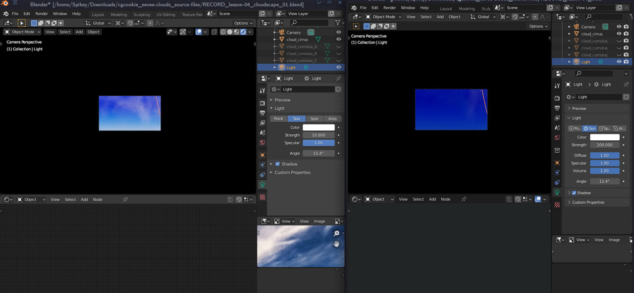

    @theluthier there are some changes in the Voronoi and Noise, but nothing essential (change in pattern, but not in ‘feel’).
    They have changed the Light Strength values for Eevee considerably though:

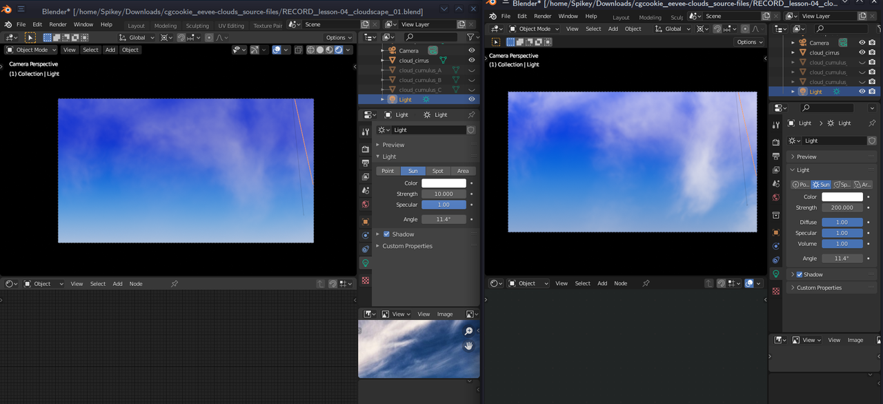

    (as a side note, there is some weird behavior when zooming in 3.2…..could be a bug:
    There is also a change (improvement) in the Volumetric Lighting and Shadows, but the main difference in this File appears to be the Light.
