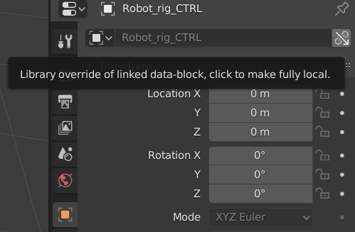

    Yeah, I didn’t expect that it wouldn’t work – it allowed me to do it before when I tried it for the tutorial, but I just tried it again in 2.83 and it also blocks adding a pose library. However, it will let you do it in the upcoming version 2.9. I’m glad to see things things are getting tackled.
    For the purposes of this course, so you don’t have to redo anything, you can head to the Object properties and click the link icon to make it local:
