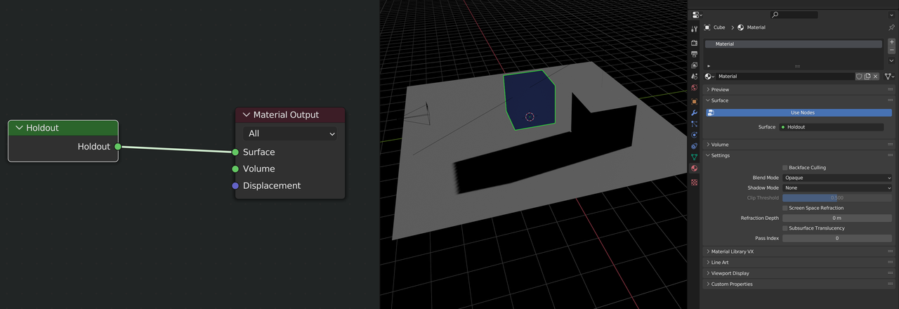

    Oh, I didn’t know that @b-rae ,thanks!
    What you can do however, is give it a Holdout Material instead and set the Shadow Mode to None, like Omar showed:
    (I wonder if ChatGPT would come up with that…🤔…now it probably will, because it sees my answer..I don’t know)
