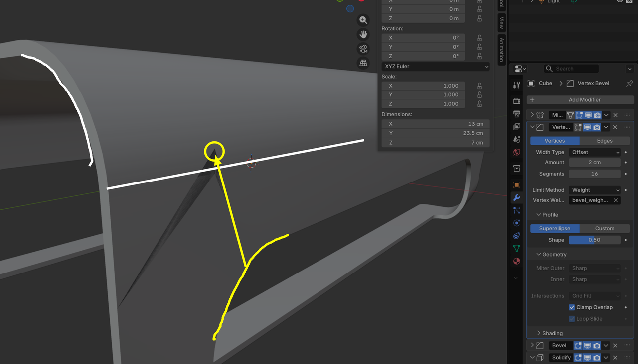

    Hi Brennan @BrennanS ,
    It’s hard to tell from that Screnshot alone, but it looks like part of the Vertex Bevel of the yellow Corner crosses over the Bevel of the white corner (if that makes sense):
    The yellow Bevel goes straight up in the Z direction, but the white Bevel bends surface.
    So, basically, the Vertex Bevels of those corners are a bit too large.
    Might be something else, but that’s what it looks like to me.
