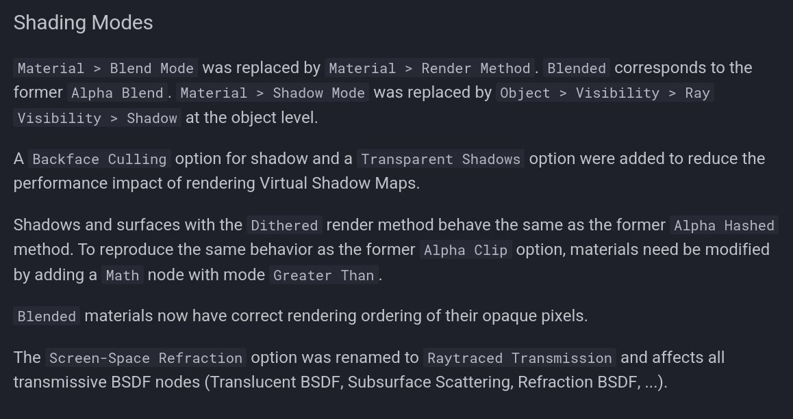

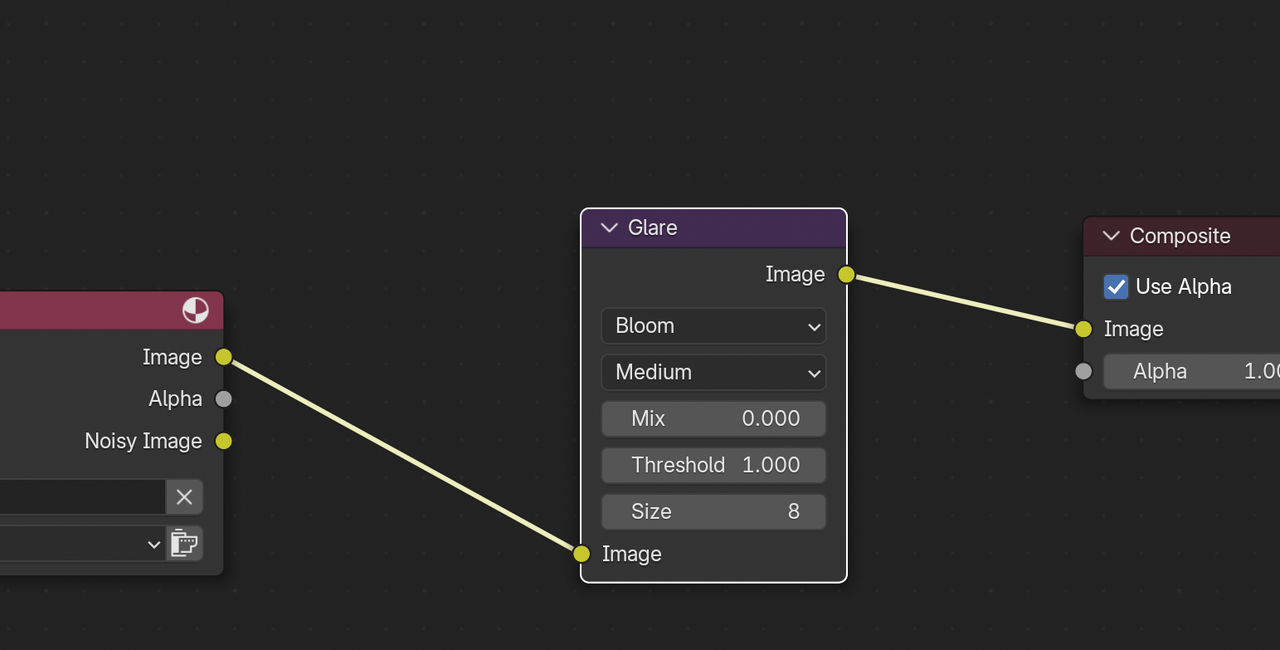

    And  ad 2. Bloom is now supposed to be done in the Compositor (just like Cycles). (Filter > Glare Node):
    To avoid these kind of issues, it is recommended to use the Blender Version that is used in the Course (until you know Blender well enough that the Versions become ‘unimportant’).
