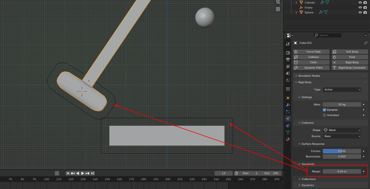

    There is a (hidden) Setting called Margin that is too high by default (change it to 0.005, for instance, or lower if needed):

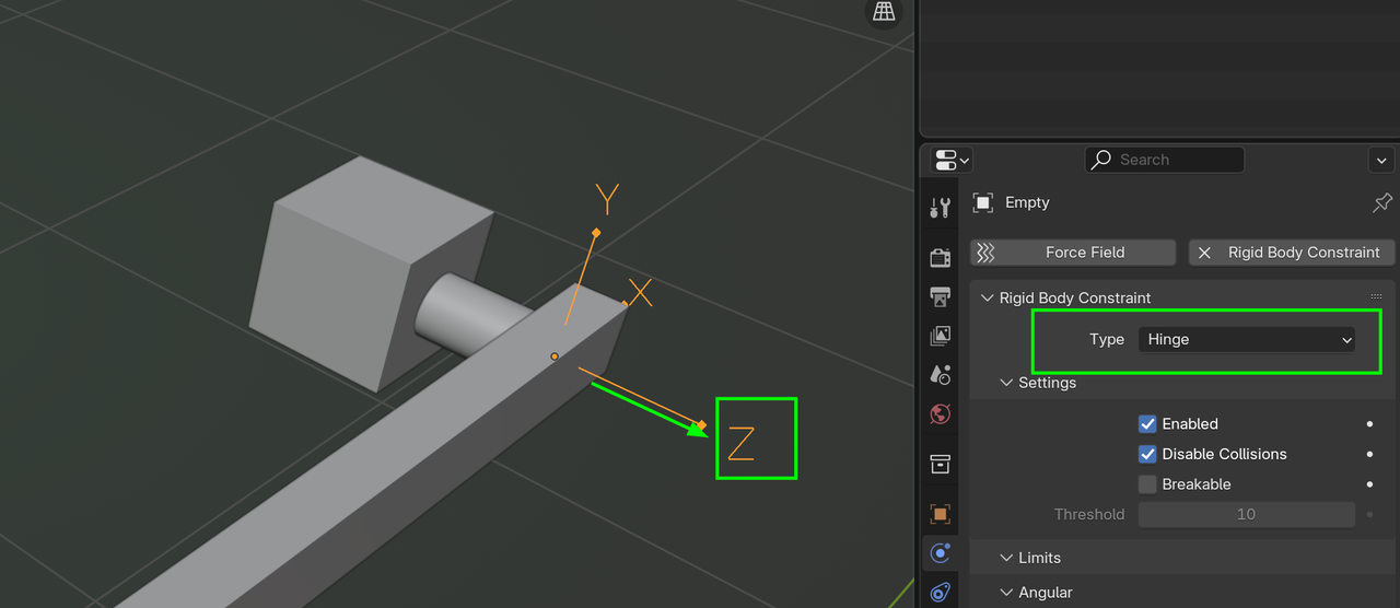

    I’d change the Rigid Body Constraint to Hinge (and Rotate it):
