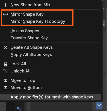

    The two mirror options in the context menu ONLY mirror on the X axis.
    But depending on your use case you might be able to activate the shape to -1.0 and then “Create from Mix”

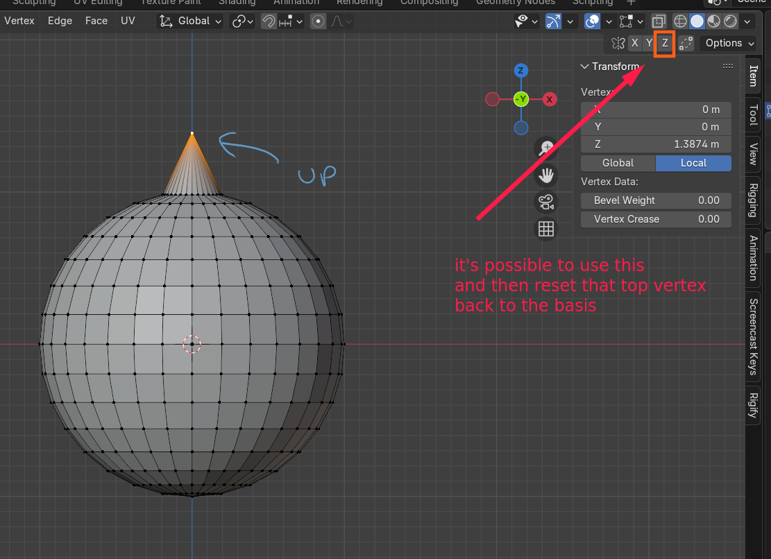

    But it’s important to remember how shapes work.  If you have a sphere and you move the vert top vertex up – then the method I described isn’t going to work.
    You could use the edit mode symmetry tools and then reset the top vertex back to the basis shape (Blend from Shape)
