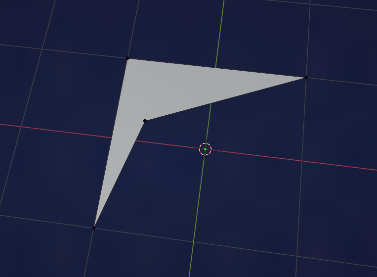

    Another problem is a so-called concave quad:
    This will give you enormous problems and headaches, when using a Subdivision Surface Modifier (again: Catmull Clark).
    So be careful with those as well!
