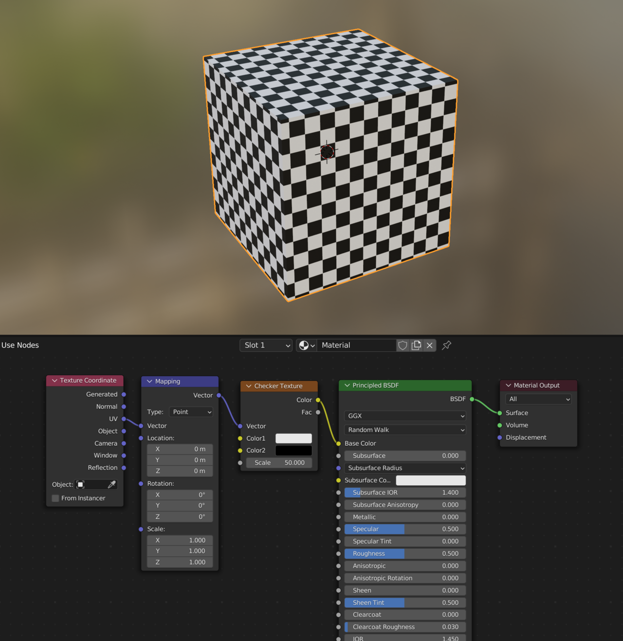

That UV island seems to be the culprit yes. You’re going to have to redo your UV’s and probably loose what you had done so far. But that’s ok, that’s just how things go. Before I start texturing what I always do to see if the UV’s are good, I use the checker texture and see the model from all directions to see if I spot some distortion of a funky face.

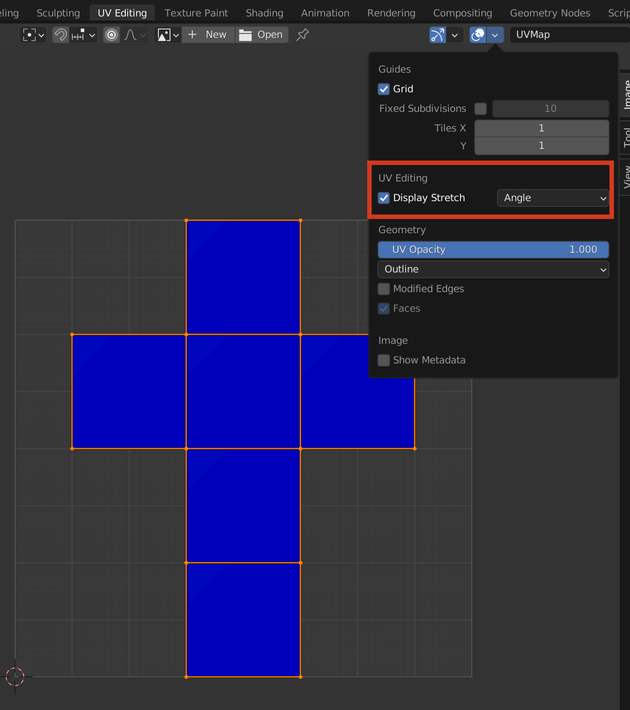

Also remember you can display the stretch to see if you have any bad UV’s
