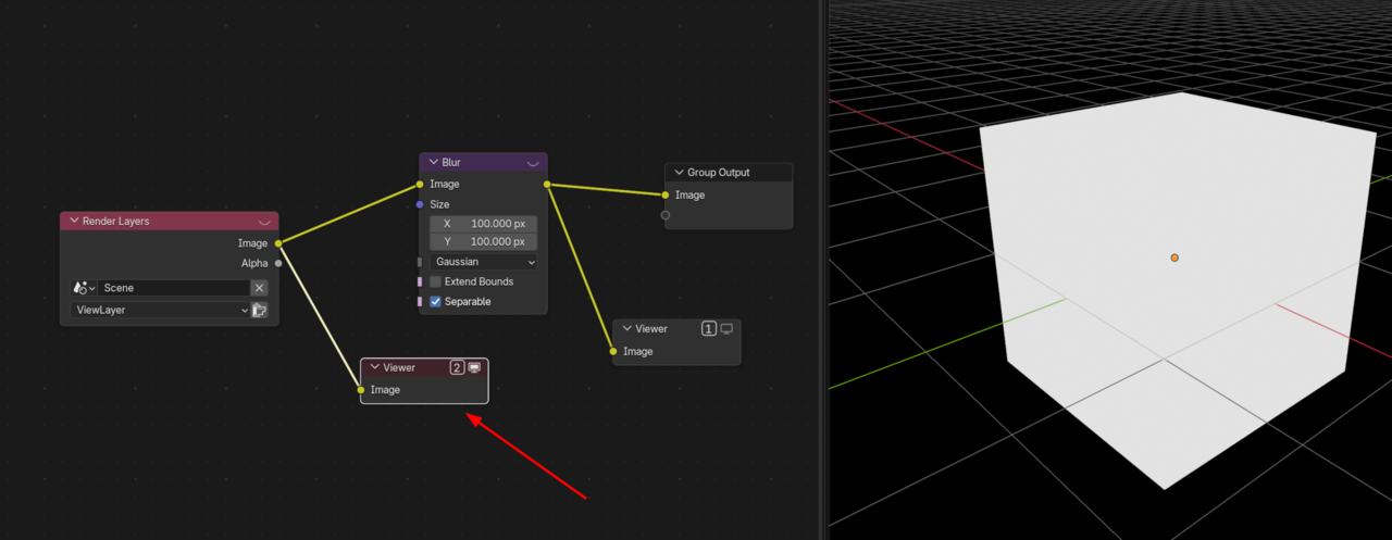

    Hi Rachel,
    The main issue is, that your Viewer Node is connected to the Output of the Render Layers Node, instead of to the Output of the Lens Distortion Node.
    So the Viewport doesn’t get the effects:
    Basically this:

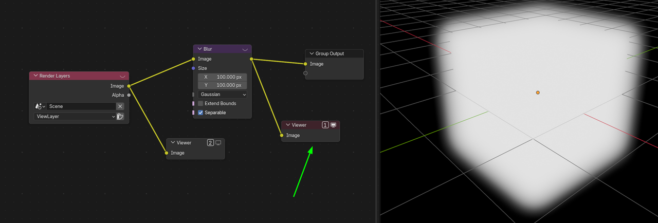

    Instead of:
    Even professionals sometimes Render an Image or Animation and then find that the Viewer is not connected to the same Node as the Output Node and the Render looks different from the Viewport. You’re in good company😉
