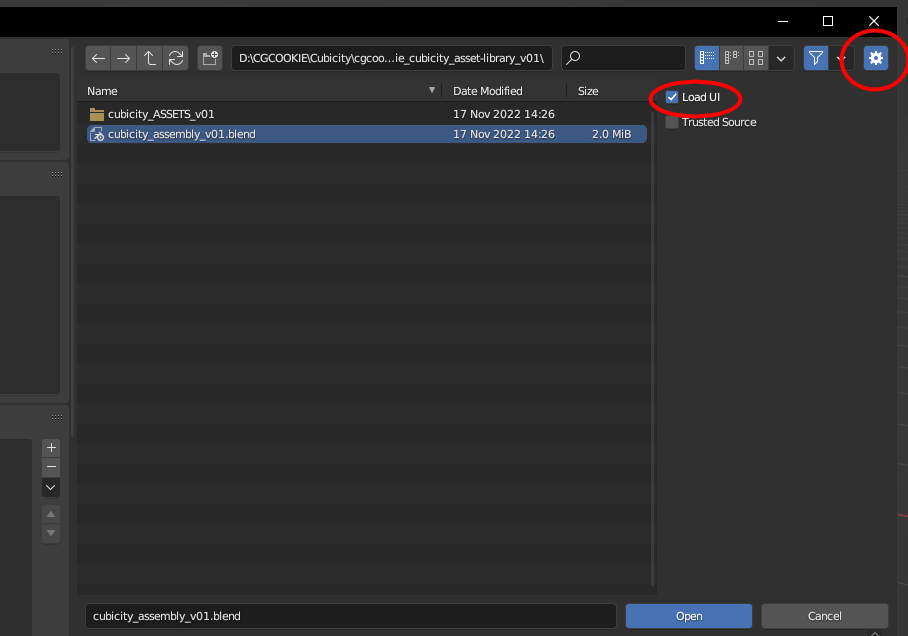

    When you open a file you can uncheck Load UI and it will keep your preferred UI settings.
    You’ll find it in the file view window on the right panel, click the cog to open the panel.

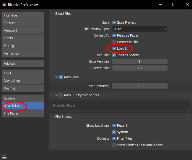

    or you can uncheck this in the preferences and every file you load will use your Blender UI settings.
