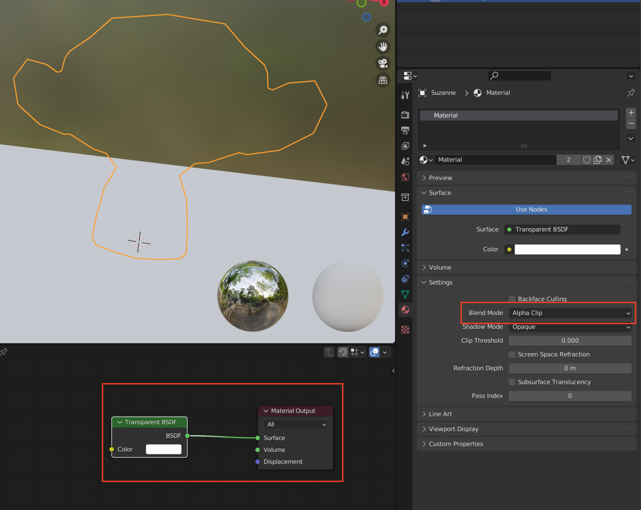

    Hello Gabriel. Look like since you are mixing with an emission shader, the transparency is not taking effect. Try the transparency on its own first.

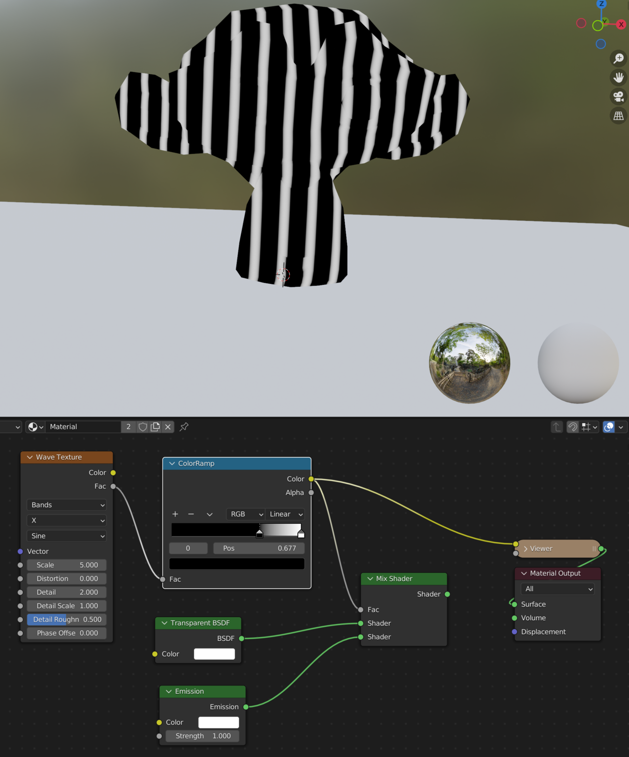

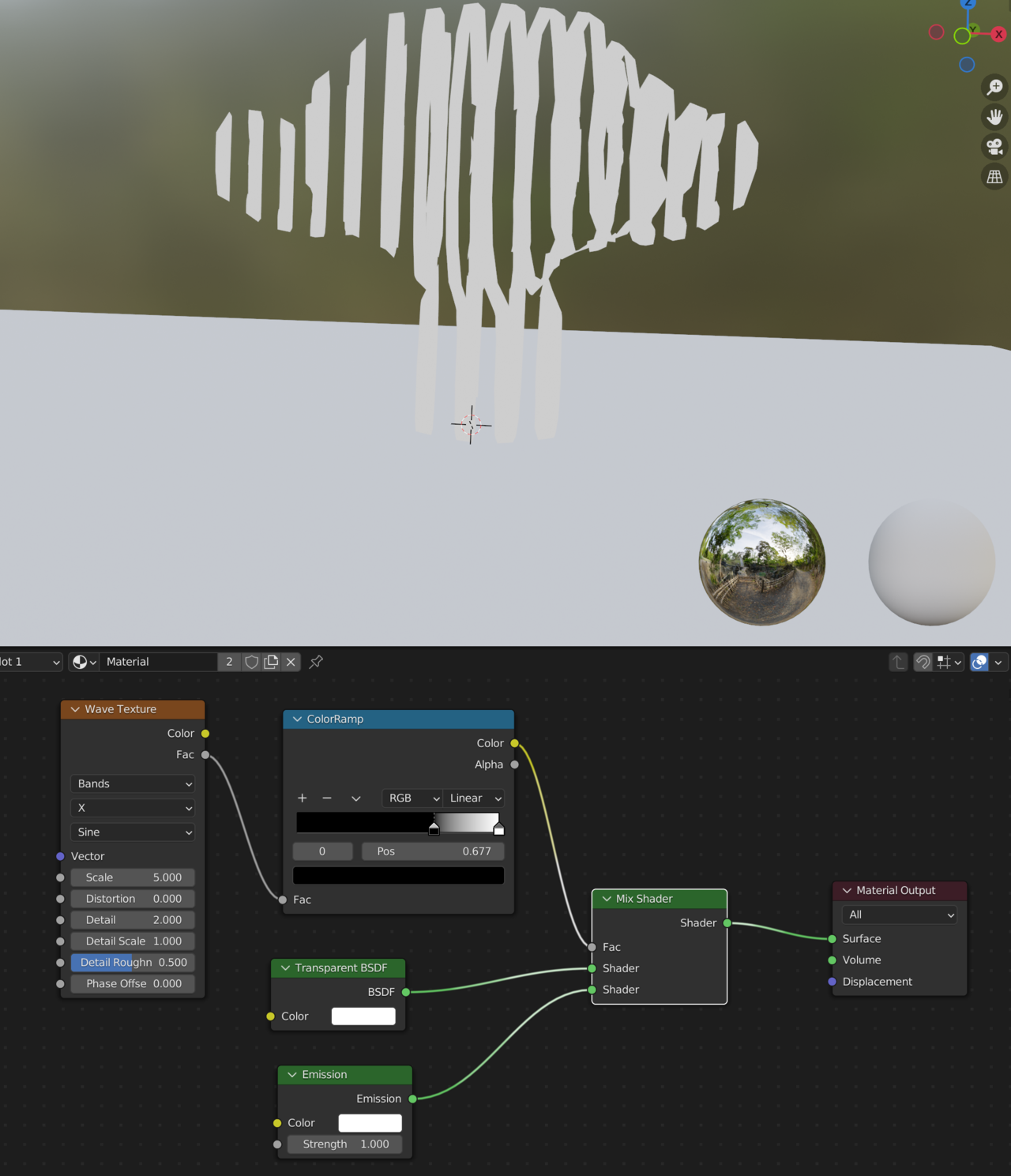

    Then when you’re mixing with the emission, try to really crank up the values with a color ramp node for the effect to really pop out.
