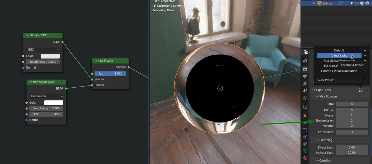

    Hi @hutygags ,
    From the way this looks, I’d guess that your Maximum Transmission Bounces are too low (or the Total Max). Maybe you are using the Preset ‘Direct Light’:
    If you switch to the Default Preset, you should be okay. Don’t worry, this will be explained later.
