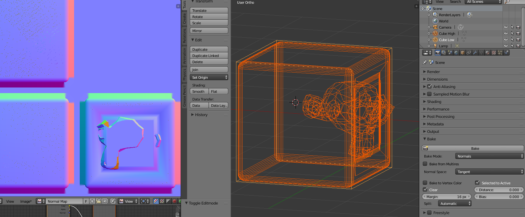

    Let’s say your high poly object has multiple layers of faces that they ray could hit. Here I’ve just got Suzanne trapped in a beveled cube.
    If the ray distance (how far it travels inwards) is unlimited and the bias is set to 0, we’ll get some noise from the surfaces overlapping exactly and you’ll only see the part of Suzanne that’s between the high poly cube’s inset and the low poly cube.
    I don’t have a good technical explanation of exactly what’s going on (it’s not moving where the rays are fired from since the bevels stay the same, and I don’t think the rays are travelling backwards at all because that wouldn’t help with the overlap noise), but here’s what happens when you turn the setting up:

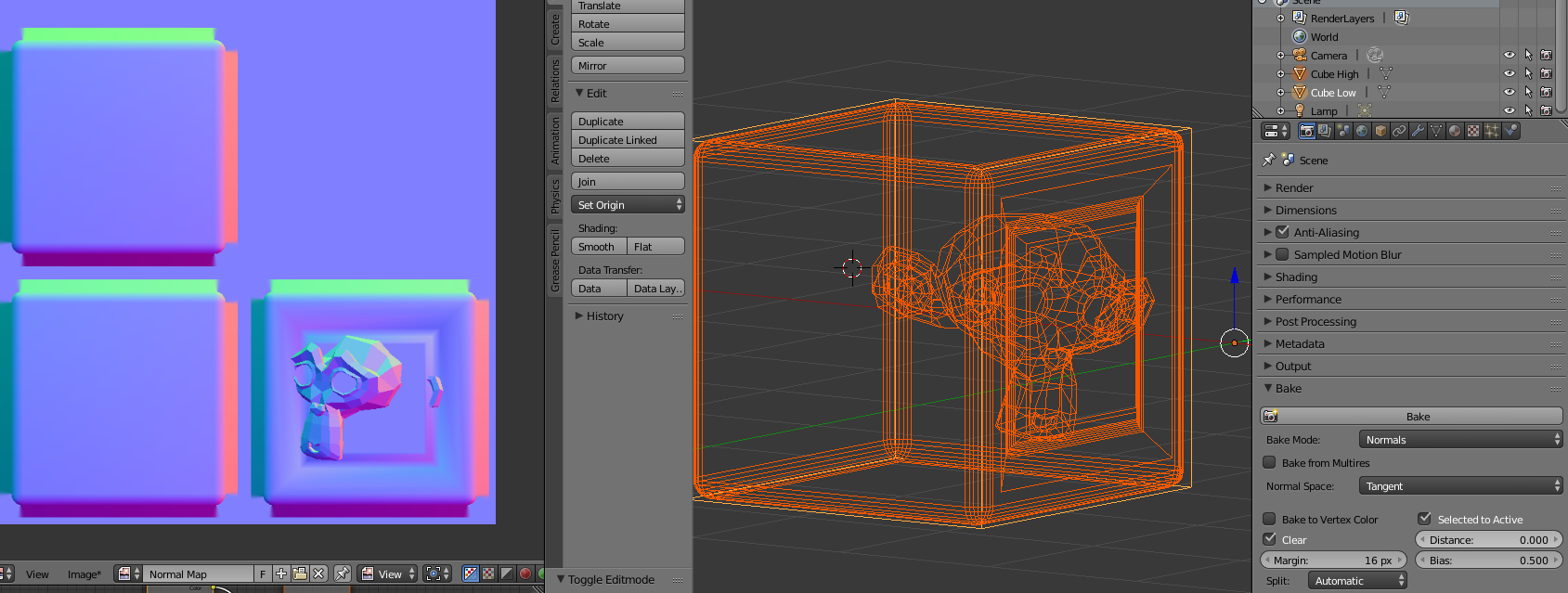

    Faces outside of the low poly object start to get included, but the bevels stay the same and don’t miss.
