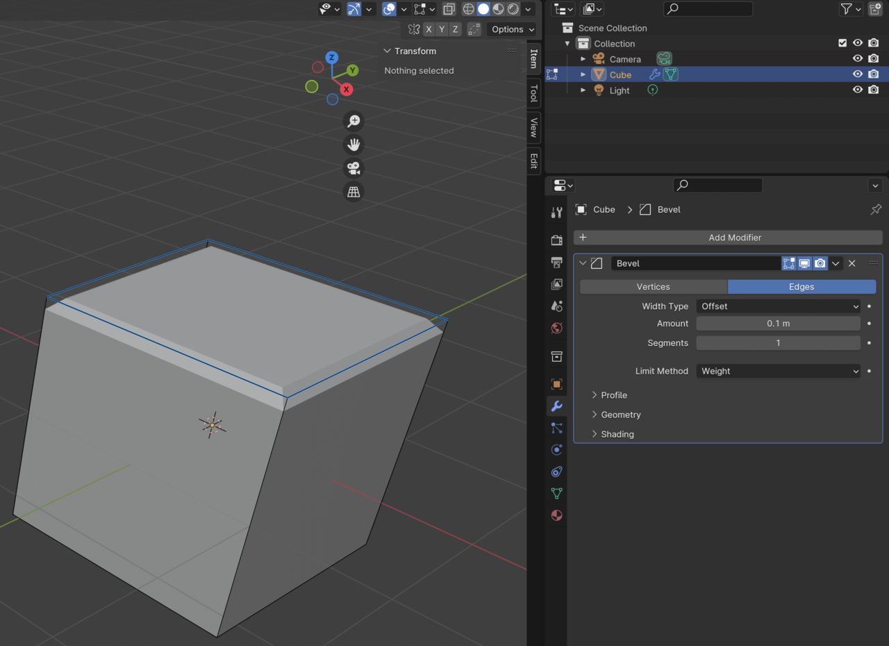

You have the Limit Method in the Bevel modifier set to weight, but you’re in edit mode and there’s no blue weighted lines anywhere. it should look like this:

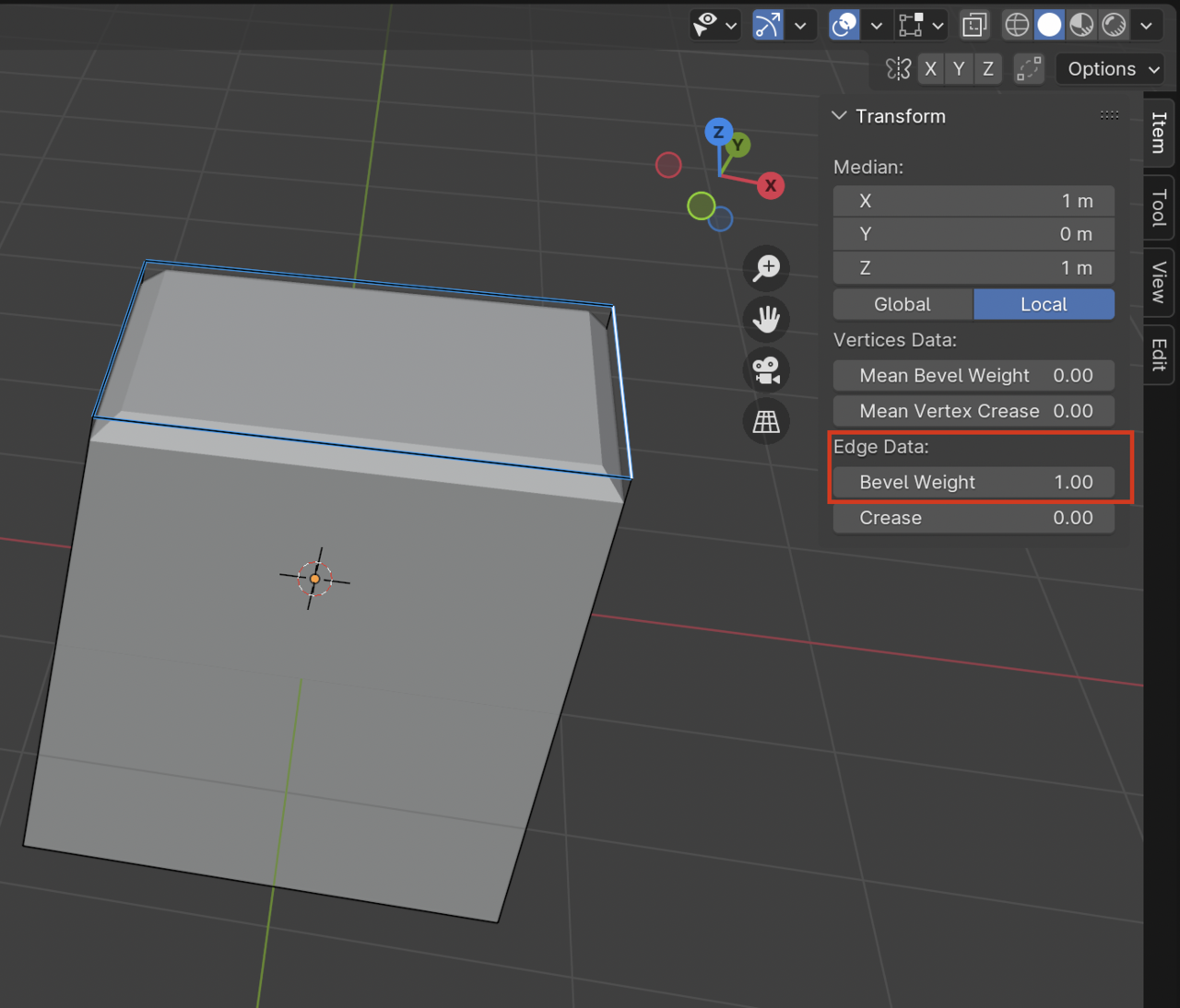

Did you set the Edge Data, Bevel Weight to 1?
