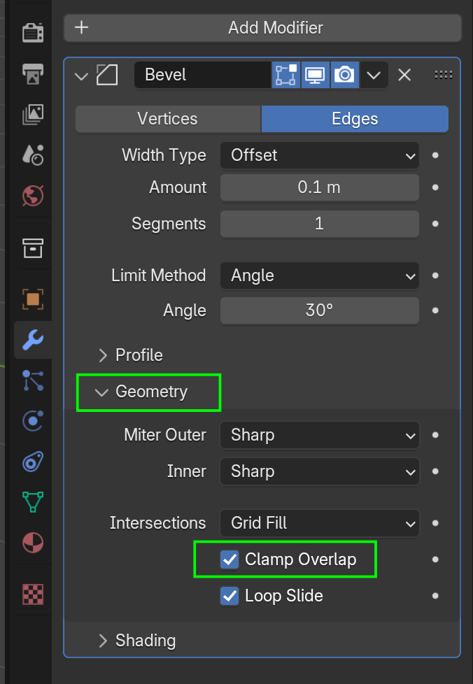

    Hi Farah @biijeeyjeey ,
    With the Bevel Modifier not working, the problem is often, that Clamp Overlap is enabled (it is by default):
    But if the Tool also isn’t working, it might be, that you haven’t Applied the Scale of your model.
     –  In Object Mode, CTRL+A > Apply > Scale.
    To be honest, there could be quite a few other things be going on, but I’d need some more information then (screenshots can often be helpful).
