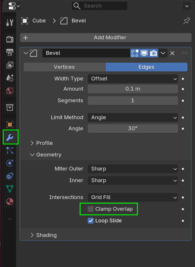

    Hi Matthieu,
    Most likely the Bevel is being Clamped by some Close-together Edges. Disable the Clamp Overlap:
    You might need to decrease the Bevel Amount when you do that.
    You can also, in Edit Mode, Select all (with A) and then: M > Merge > By Distance.
    And make sure your Scale is Applied. In Object Mode, CTRL+A > Apply > Scale.
    If that all doesn’t help, ask again and add some screenshots (whole UI).
