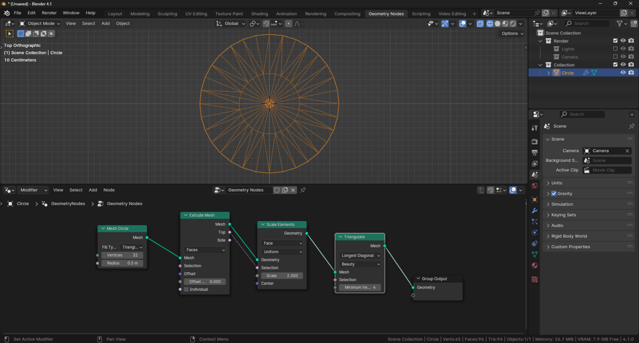

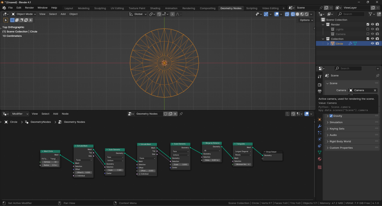

    You could extrude a triangle fan circle then triangulate, but as you mentioned the process in the lesson is a ’roundabout way’, all you are doing is creating another ’roundabout way’.
    The cone gives you the option to change the side segments, whereas the extrude and scale method below is limited without adding more and more nodes.
