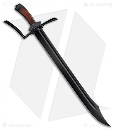

    Week 3: As for the material, the blade turned out wonderfully. It reads very well as a polished but used metal blade, reflecting brilliantly in the light. However the cross guard reads a little more like obsidian to me than metal. I should say that black metal does seem like a thing though:
    It looks like a more modern look to me, not the time period of pirates. But if that’s what you were going for, it’s a valid artistic choice.
