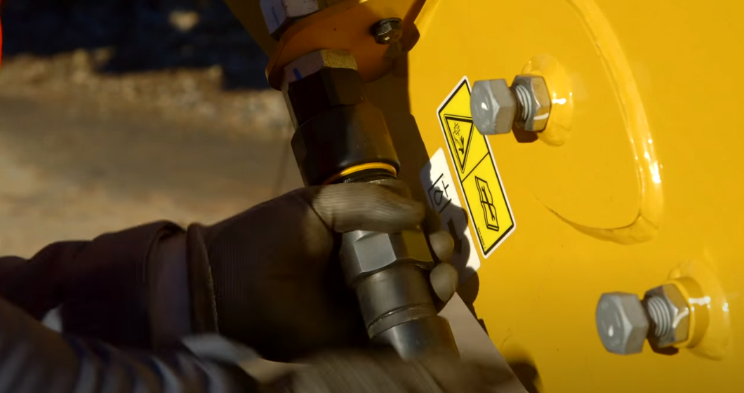

    However I too was thrown off by the actual scale of the hydraulic lines as I modeled, especially when I found this video:
    Which is a zoomed in shot of this part:

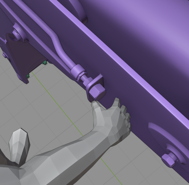

    The fitting is way bigger than I estimated perceptually. However whenever I threw in a 6-foot human mannequin and placed his hand in the same spot, it didn’t feel that far off:
    For the black lines (which seem thicker in photos) I’ve gone with 3/4″ diameter and for the metallic lines I’ve gone with 1/2″. What do you think @blanchsb?
