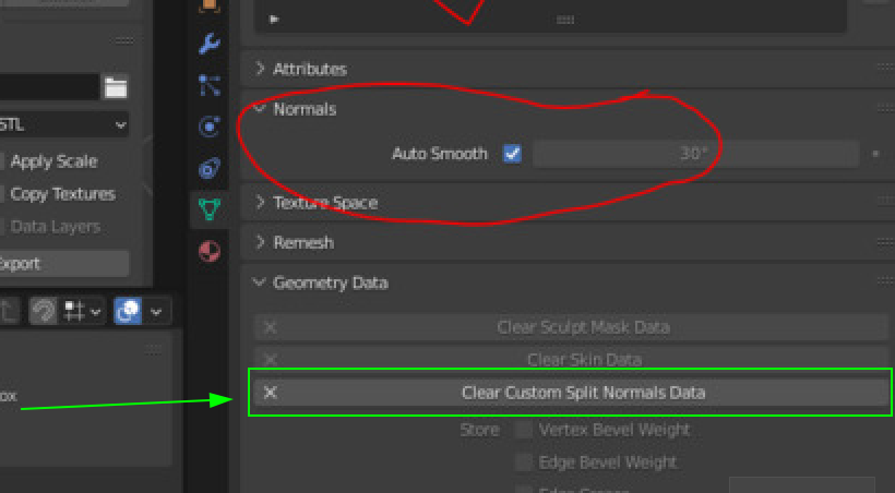

    it was not so much the Autosmooth per se, as the fact that you have Custom Split Normals (and no, I have no idea how you got them).
    You should clear them here:

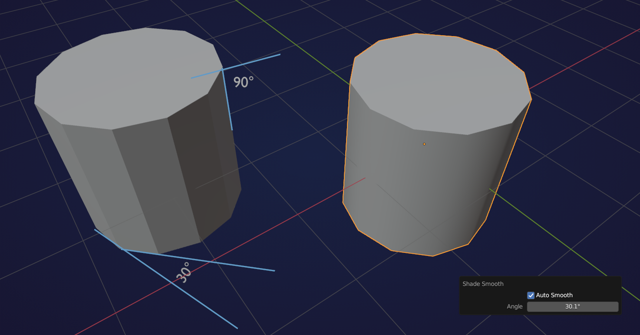

    Auto Smooth shades angles below the given Treshold Smooth and the others Flat. Mind how the angles are measured though:
