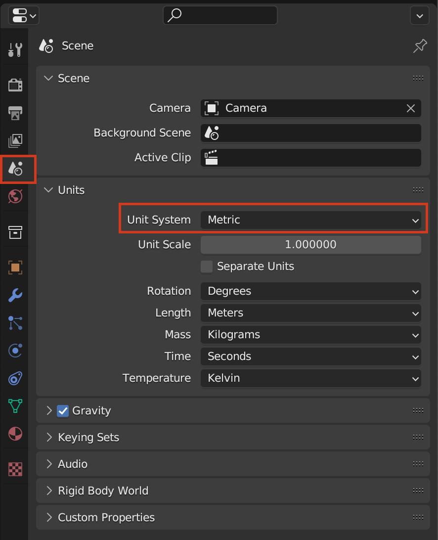

    For sure other software’s that are meant for precision are better than Blender at it. Yet Blender can do a good job if you want to model with precise measurements in mind.You can change the units and scales here:

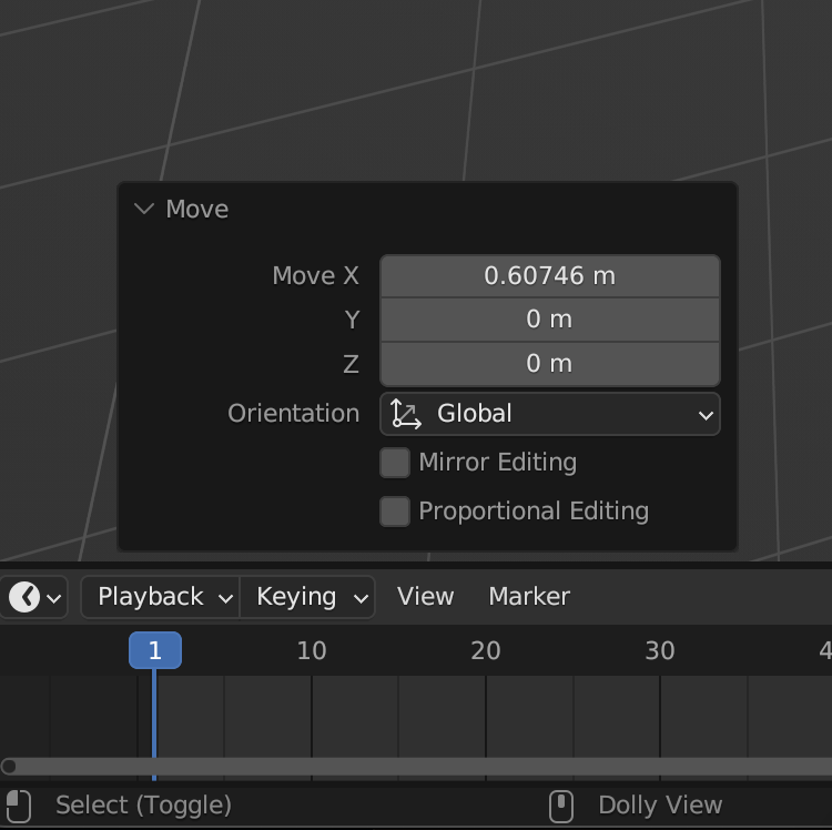

    You can input values in the Last Operation panel for example:
    You can also do it with the keyboard. So for example G to grab, X to lock in X and 0.05 to move 50 millimeters in the X direction.
    The tools are not as fine tuned for this as other programs, but you can totally accomplish it in Blender as well.
