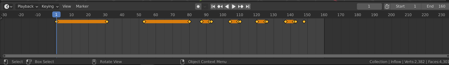

    Here’s a example scene of what I think you are trying to achieve. Flow, trickle, drip, drip, drip.
    As you see from the timeline on the inflow object the scale is reduced from f31 to f53, flow to trickle, and then from f80 to f87 , trickle to stop, then at f92 to f93 an increase in scale, I increased 0.1, just to create a drip. Then duplicate the last 3 keyframes and move them later in the timeline to create more drips.
    Tip: keep it simple while testing, then scale up for your scene.
